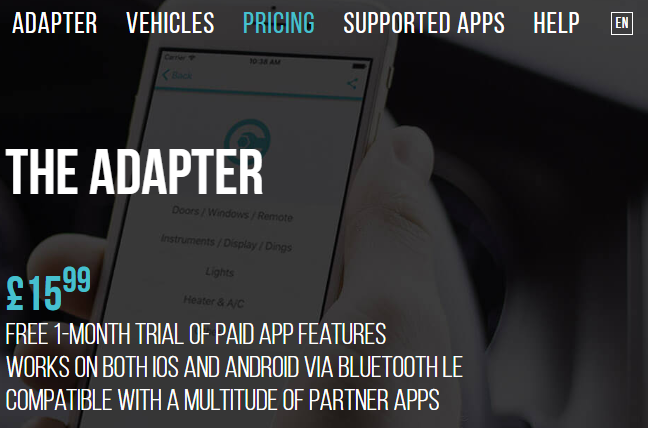

Just sign up to Carista, use their dongle and make the change yourself, it's dead easy. £16 delivered to your door with one months free access to the app...
https://caristaapp.com/pricing

Thanks for the quick reply, that would be an amazing easy fix! Does it definately have the ability to toggle the fog lights across? Is the software relatively easy to pick up? (sorry for all the questions, I had an ancient saxo with bolt on everything before so didn't really have to deal with ecu issues!)
