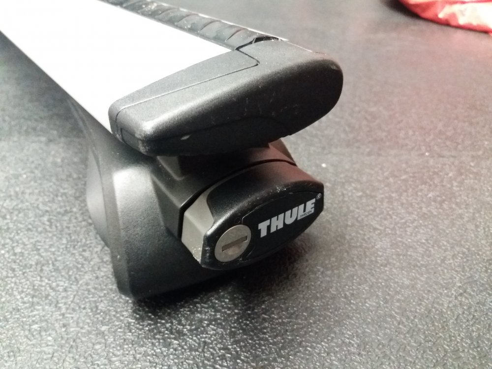

Whichever make of bar you end up buying, make sure that the foot pack that fixes the bars to your roof rails is the correct fit.
As an example with Thule bars and foot packs; several people have used the Thule 757 foot pack on previous cars they've owned with raised roof rails and now think they can move them over to the Kodiaq. I thought the same as I'd used the 757s on a previous Superb estate and thought they'd be suitable for my Kodiaq.
They are not, as the roof bar angles on the Kodiaq are different to my previous cars and the 757s are a poor fit and could be dangerous !!
The Thule 775 foot pack is what Thule recommend for the Kodiaq, and these are what I now have and they're far superior to the 757s for use on the Kodiaq.

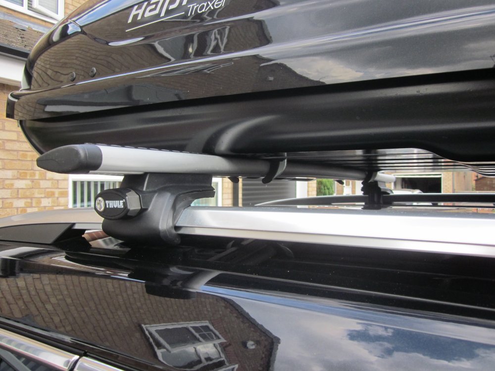

The Thule 757 foot pack fits tight as a glove on my Kodiaq.
Not sure what you mean by 'poor fit' but they are every bit as good as they were on the two previous Octavia's (MkII & MkIII)...
All the way to France and back, fully loaded. They didn't need tightening.
Thule's 775 foot pack is their latest generic one-size-fits-all design, it is designed to fit almost all roof rails. Since it's release Thule also recommend it for use on the Octavia, but also continue to list the 757 as being suitable. I thought I'd wait until my Kodiaq was delivered before deciding if I'd need a new foot pack. It was quickly clear that the 757 fits fine.

I knew someone would come back and say that the 757s are ok.
I'm glad they're working for you, especially as you're carrying a load that generates a lot of wind lift. I carry 16' Canadian canoes and I would never risk them coming off by using 757s.
The 775s might be generic but they include a metal strap which passes under the roof rail making them far more secure.
I could never in all good conscience recommend 757s for the Kodiaq and neither do Thule. Also, the bars and feet that Skoda supply have the same type of attachment as the Thule 775s.

I think the wrap around strap on the 775's is the basis behind the one-size-fits-all type approach as they're far more adaptable to slight changes in roof rail sizes and shapes. Must make Thule's and our lives easier having fewer foot styles / packs.
My roof bars are called the 'WingBar', they are old though, I'd guess at least 5+ years so perhaps Thule have changed / discontinued them...
