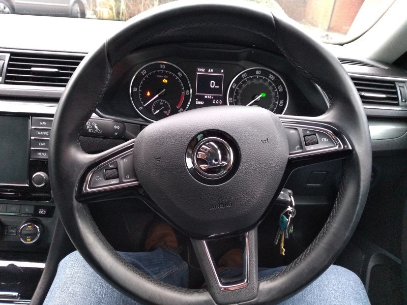

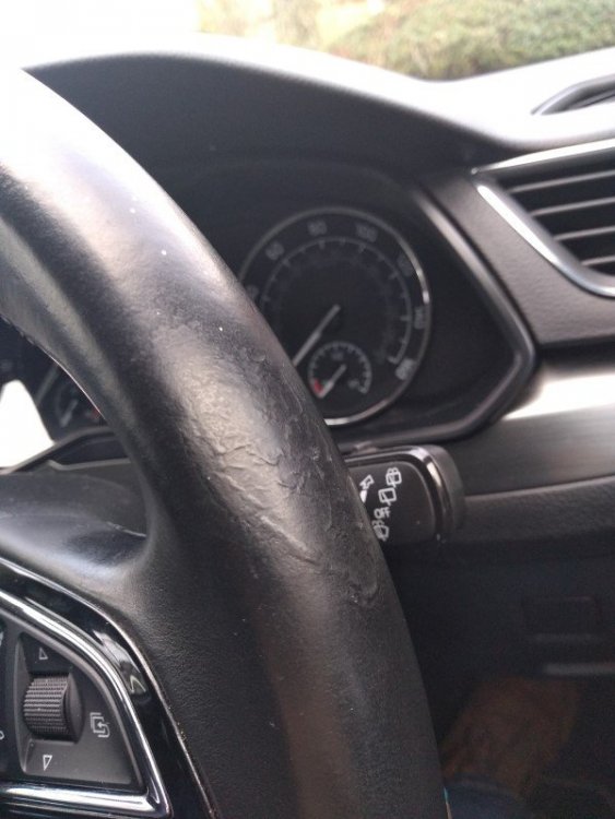

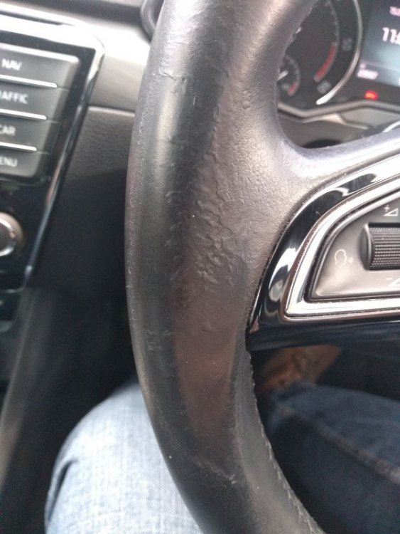

Bought a Skoda Superb 3 the other week. The steering wheel was in a bad state as per Photos 1 & 2

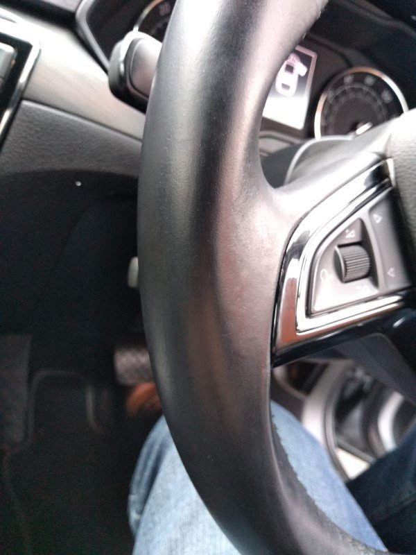

Job entailed following the instructions in the kit - Clean, dry. Then a bit of sanding and filling where necessary, Dry with a hairdryer then apply the colour. Many thin layers work the best. Dry in between layers and leave to cure for a couple of hours

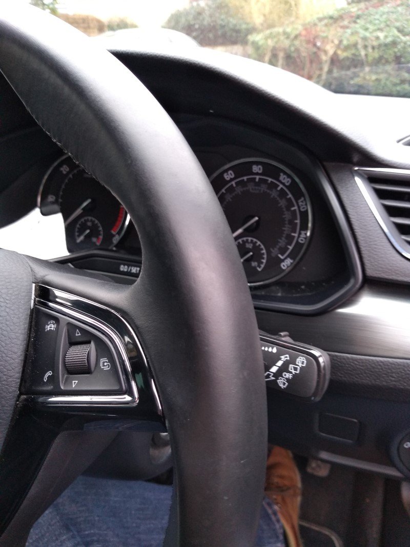

Final pictures show the finished article. May give it a couple more thin coats yet
Dead easy - IF you follow the instructions and exercise care when sanding
