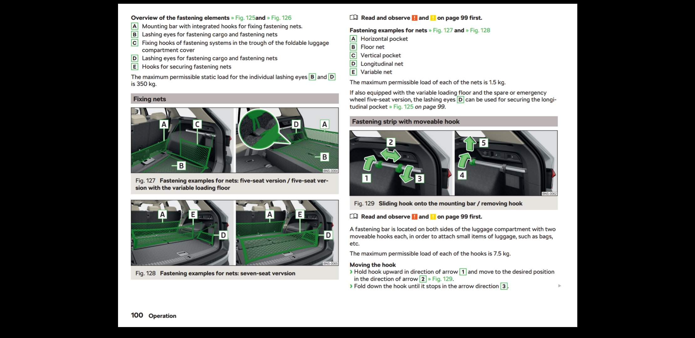

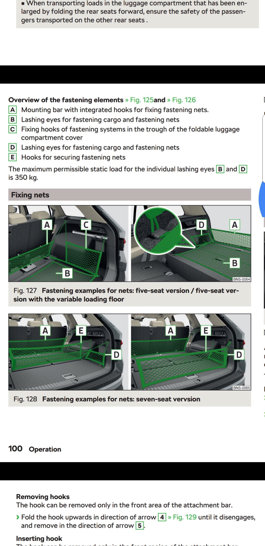

From the owners manual
Cheers
the nets defiant aren’t as useful as the Octavia ones (I’m glad I didn’t spend actual money on them as they were included)
i would prefer a “b” net to cover the floor when I need to lash things from rolling around but as it’s the 7 seater with the higher floor none of the hooks are actually accessible. The D net is also a bit of a joke. Why not just have a partition on the side rather than a net which really won’t hold anything?
again as the plastic hooks in the boot only tie against fabric type pulls on the nets they won’t hold very well and keep pinging off.
Not it really worth the hassle, a pity as I keep coming back to them being so much more useful in the Octavia
Have you actually tried using it yet? The net holds pretty much anything I put in there, and whilst a partition could be useful, a net you can or not have is a lot more flexible. Also, you have to be able to lift the flap up that forms the base of that cubby when you’re stowing the load cover to use the third row of seats, so I’m not sure anything more rigid or permanent is actually viable.
