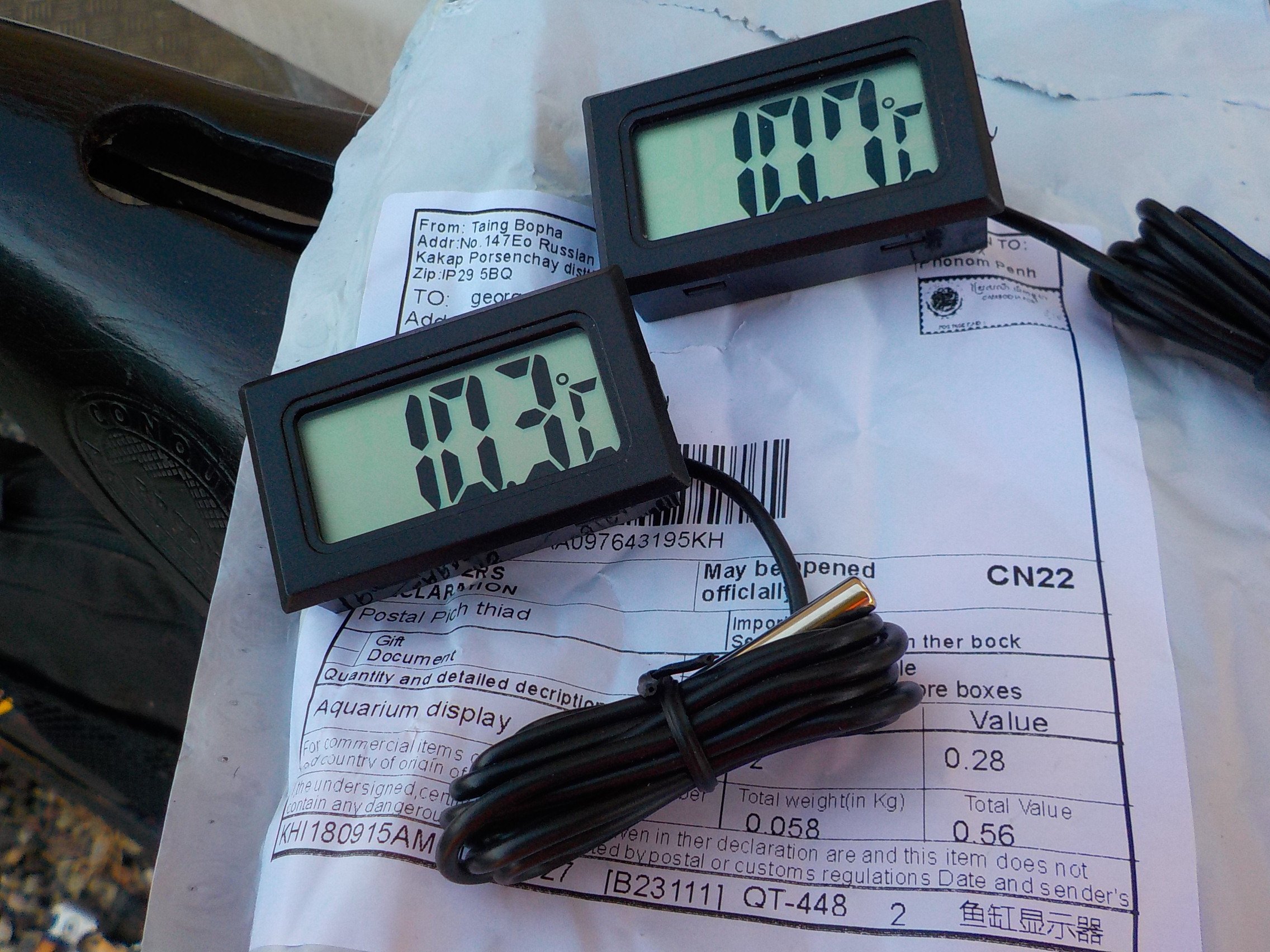

No idea the threshold but have always had the system that can detect a tyre changing a few psi from the cold setting and then when tyres are up to heat and when i check the tyre pressure hot if there is a warning i hold the digital thermometer to the tyres and see if any are heating up more than the others.
Sometimes they do due to the slight under inflation and sometimes a brake binding or a wheel bearing going.
Less than £1 each and kept beside the Tyre Pressure Gauge.
