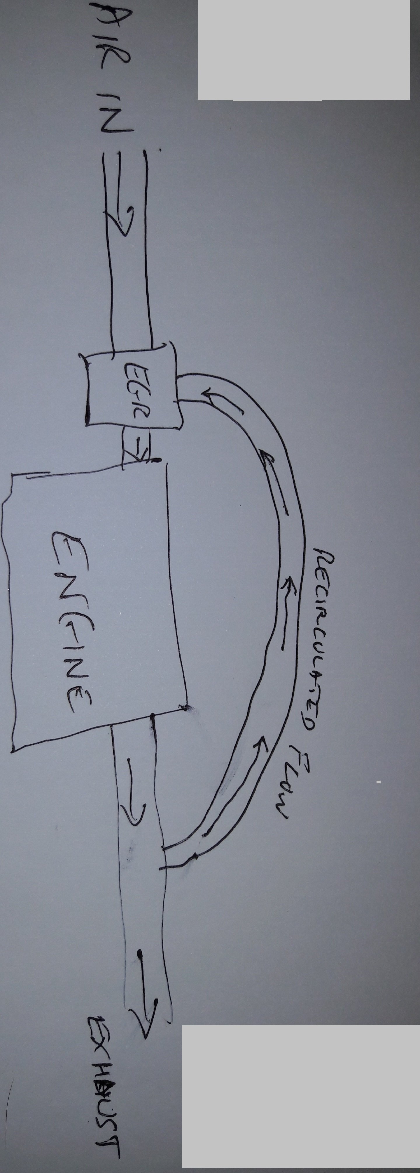

I've sketched a simplified diagram of an EGR system to try to explain and answer some of your questions.
Recent engines are designed from the drawing board to work with EGR, in order to satisfy stringent low-NOx emissions targets. Anything you do to change the EGR system (other than cleaning the valve) will increase the NOx  output of your car, and as such is illegal. MOTs don't measure NOx though, so if your conscience allows, you could modify things in a visually unobvious way and get away with it.
Lots of people have done it, but mostly on older generation cars where the engine management electronics isn't keeping a close eye on all the sensor readings. Almost certainly on your car, if you disable the EGR somehow, you'll have a permanently lit emissions warning light.
If the EGR is blanked off, this tends to mean blocking the 'recirculated flow' path of my diagram. This means that the EGR valve will no longer receive a stream of exhaust gases, including the particulates which tend to combine with oil mist in the incoming air to form the 'crud' that tends to build up over the years and block the airflow through the valve, into the engine. Without the recirculated flow, it will be totally unable to do its job of reducing peak combustion temperatures, and thereby the poisonous nitrogen oxides (NOx) that form at these high temperatures.
If you don't clean out the EGR valve the flow of air into the engine will gradually be reduced, google some pictures of blocked EGRs. So not the same as blanking off, at all.
With your diagram and explanation it explained it very well.... thanks
