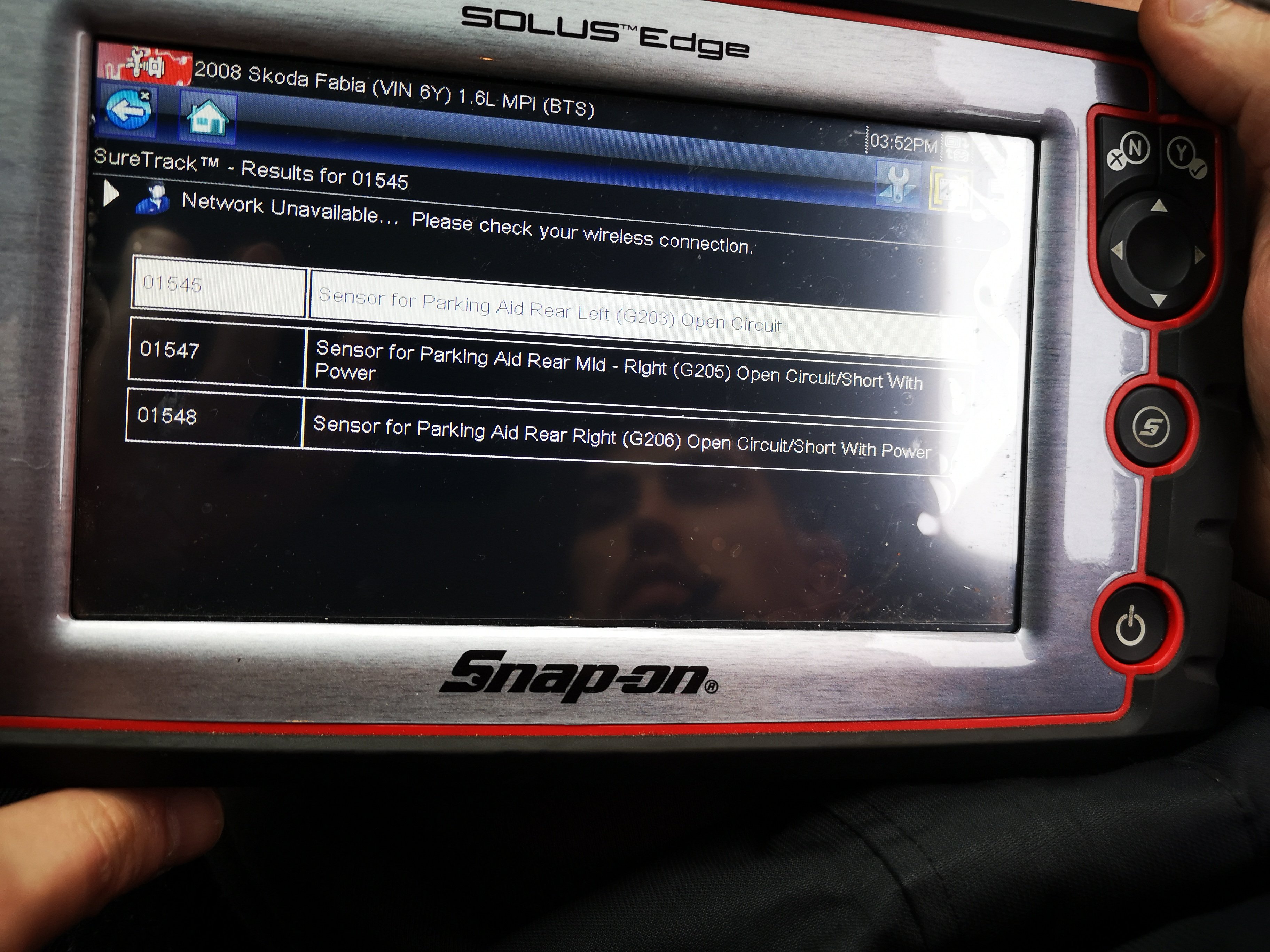

I did the same thing this weekend, I used a vcds and it's showing 3 sensors that are faulty and needs changing or it could be the cable?
Nonetheless, are the sensors from AliExpress on any good?

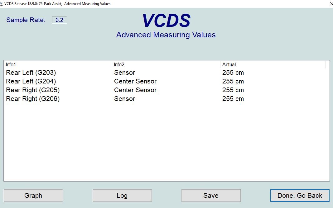

With VCDS you can go into I think advanced measurements in CTR 76 and you can see the sensors in real time when someone approaches from behind.

Is this not worth checking the loom out..........bit of a rarity to find 3 sensors faulty,
That's also an option I considered yesterday. I will just buy everything and return what I don't need. Problem solved.
