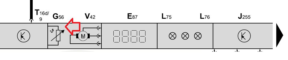

Well, apart from the (G56) one inside the Climatronic control unit, of course...

As mentioned the sensor is in the panel.
