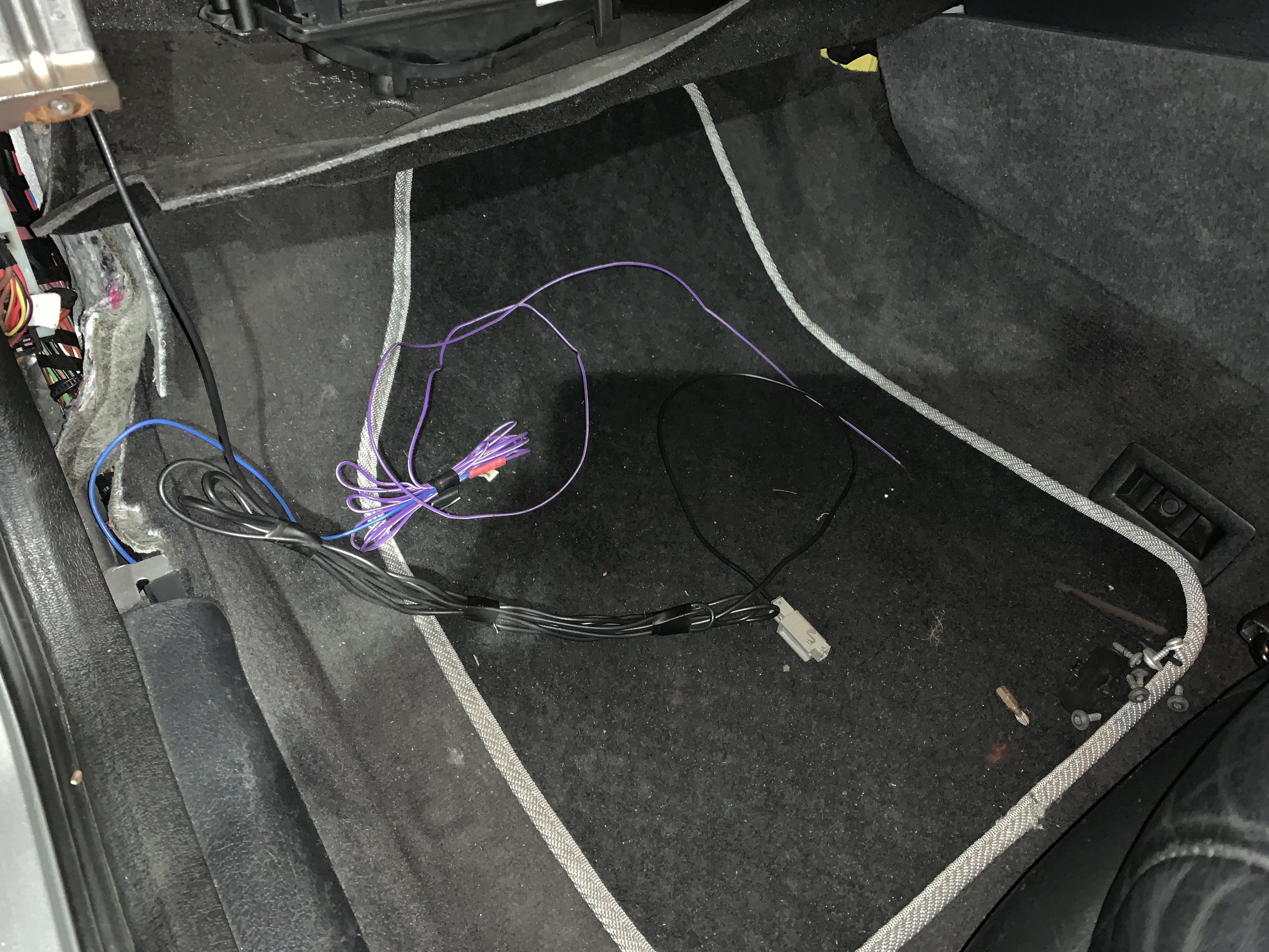

I saw a wire hanging in the passenger footwell and after removing the glovebox found two unconnected wires that have been pulled or broken. I removed the radio and found three unconnected wires from there. I’m not sure if this is a unrelated radio issue or the cause of the other faults.

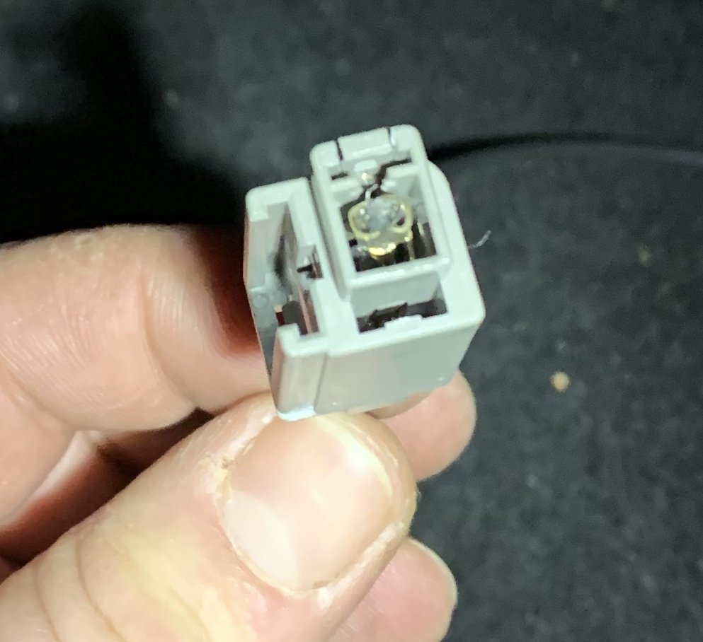

Black wire with grey plastic connector - no obvious location to fit.
Purple wire with white stripe and orange spot - reverse gear signal label.

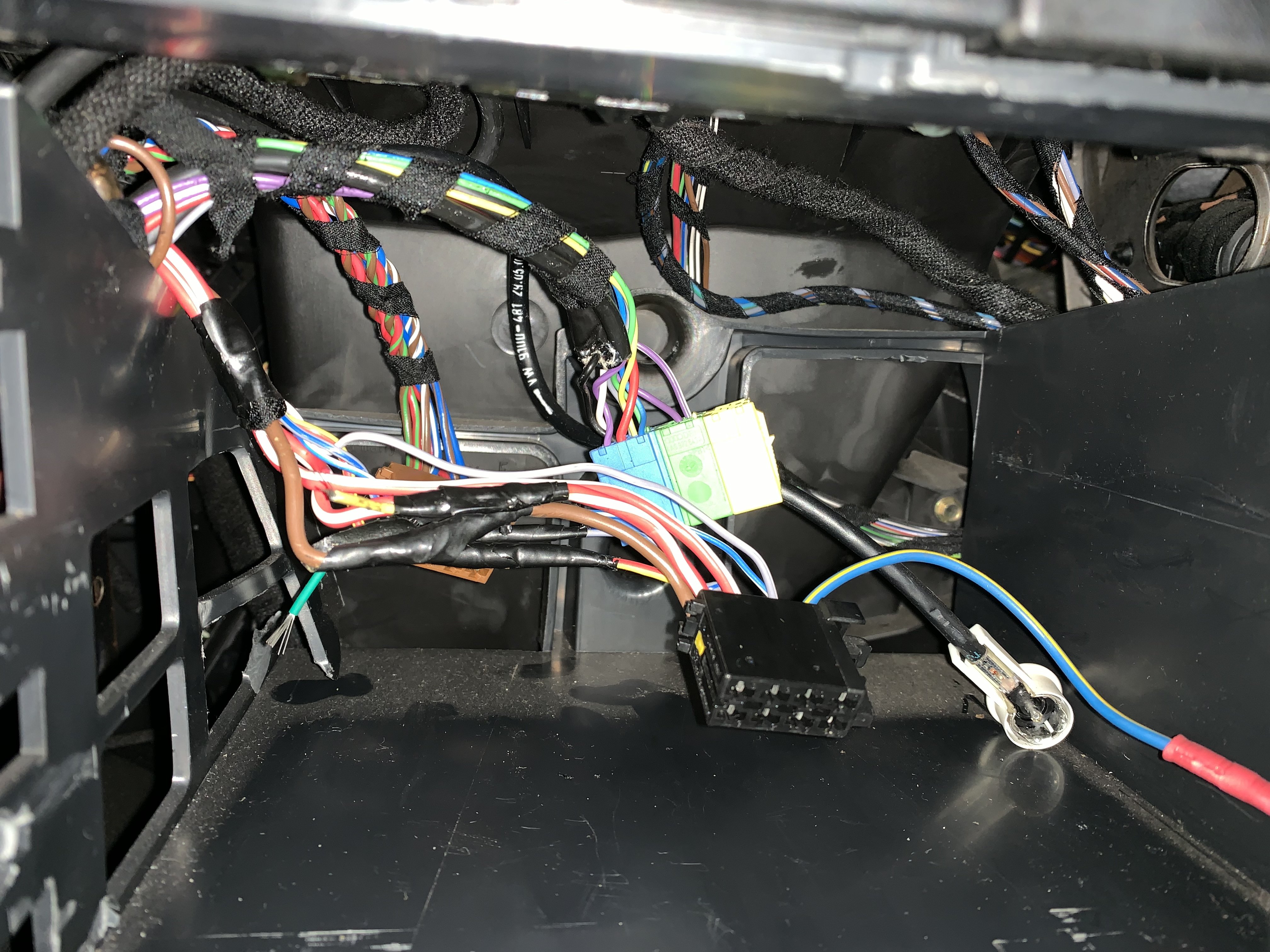

On radio loom
A wire added to the brown
A wire added to the red and white
A blue and yellow wire

If so, Brown wires are neg/chassis/ground, Red+White wire is the supply to the radio via fuse 42.
Looks like someone added some accessories and that is where the extra plug goes.
My guess is that they connected an additional bass/amplifier unit (best guess) or bluetooth/ phone connection unit.
