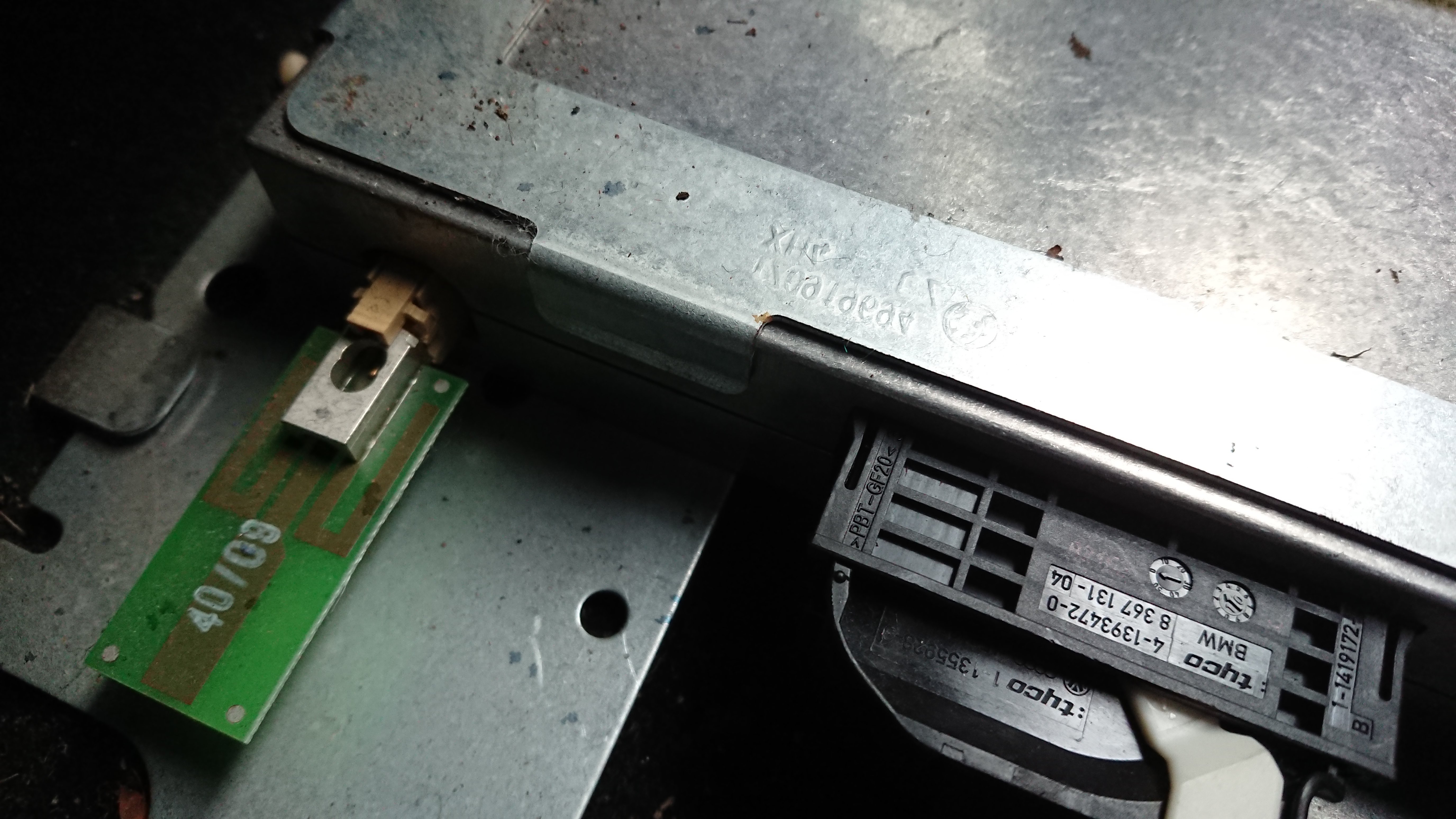

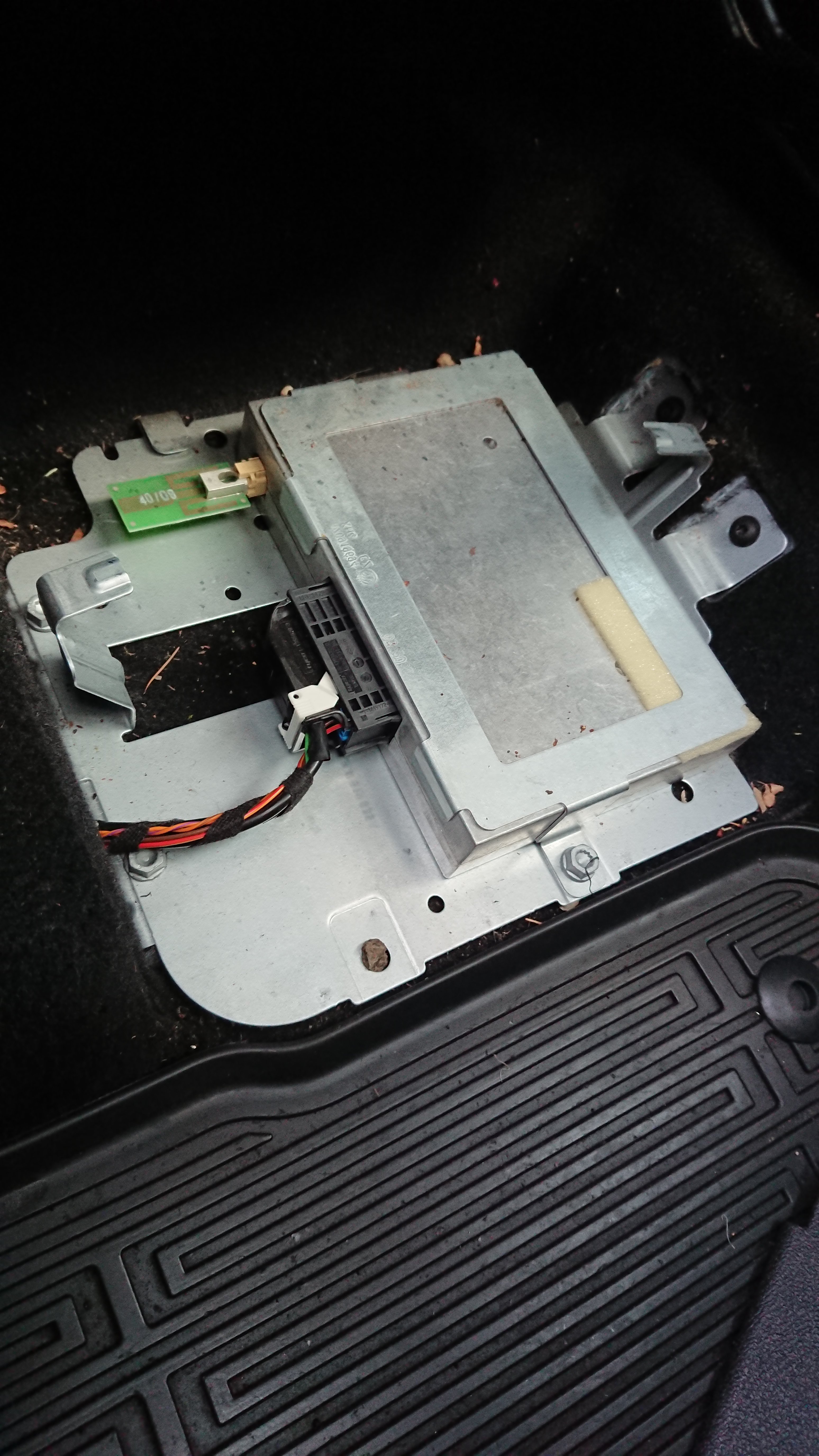

I have looked under the plastic cover in front of the drivers seat and I do have a box/module.... But it is a metal one and not one like I have seen via Google search.
Is this even a Bluetooth model and if it would need replacing what part number should I be looking for.

Yes, that's your bluetooth module. I had thesame one in my yetimand connected plenty of different android handsets to it. Sounds like it may be faulty...

I have to say that my Bluetooth module did not look like the one in the OP's photo: it was in a black plastic case, not a metal one.
