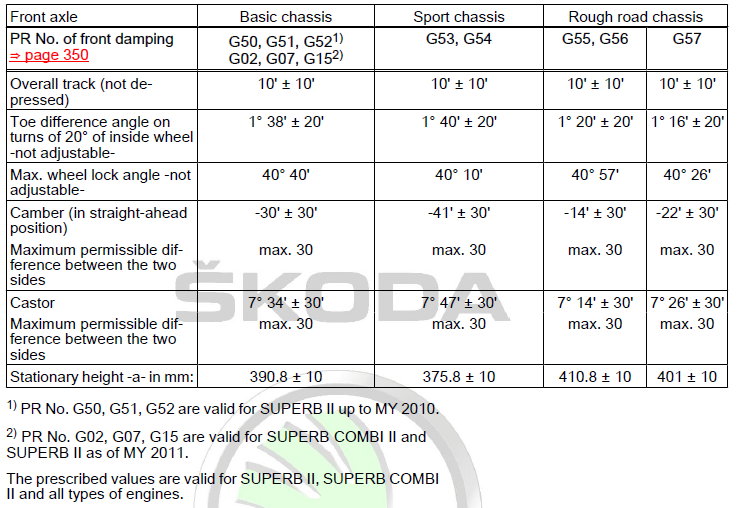

FYI our 2010 CR170 Elegance has the factory sports suspension. The code is 2UC   SWP   Sports version (suspension = 15mm lower).
