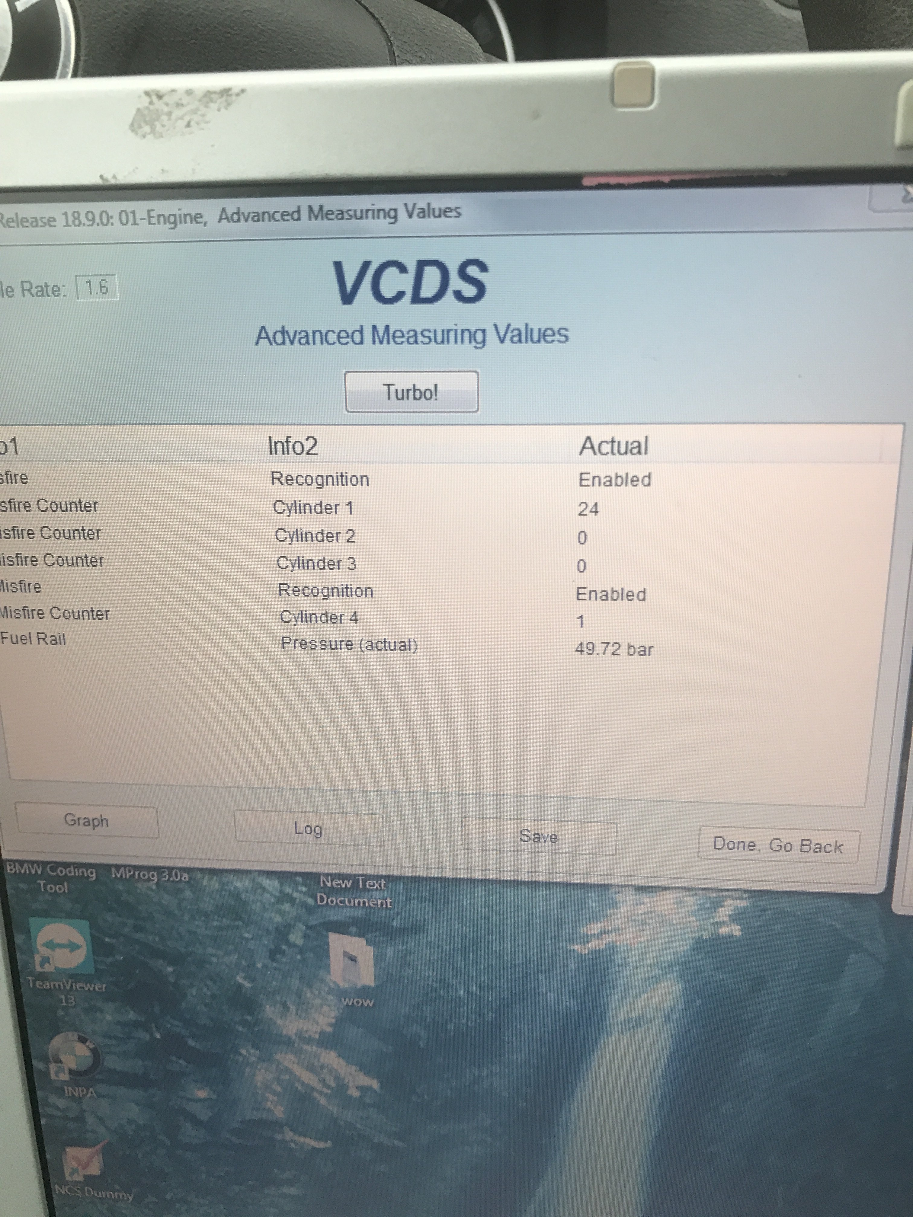

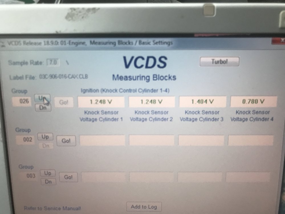

Hi, i have a problem with a octavia from 2010 ,1.4 tsi engine. I had the chain snapped and replace valves ,chain, oil pump. Now i am having a problem on idle. It s shaking. Tried to replace spark plugs and coil packs nothing. No errors on vcds .done a  compression test all fine. Sometime it gives me on idle missfire on piston 1. What can it be? Will the n205 valve be faulty?
pls help
