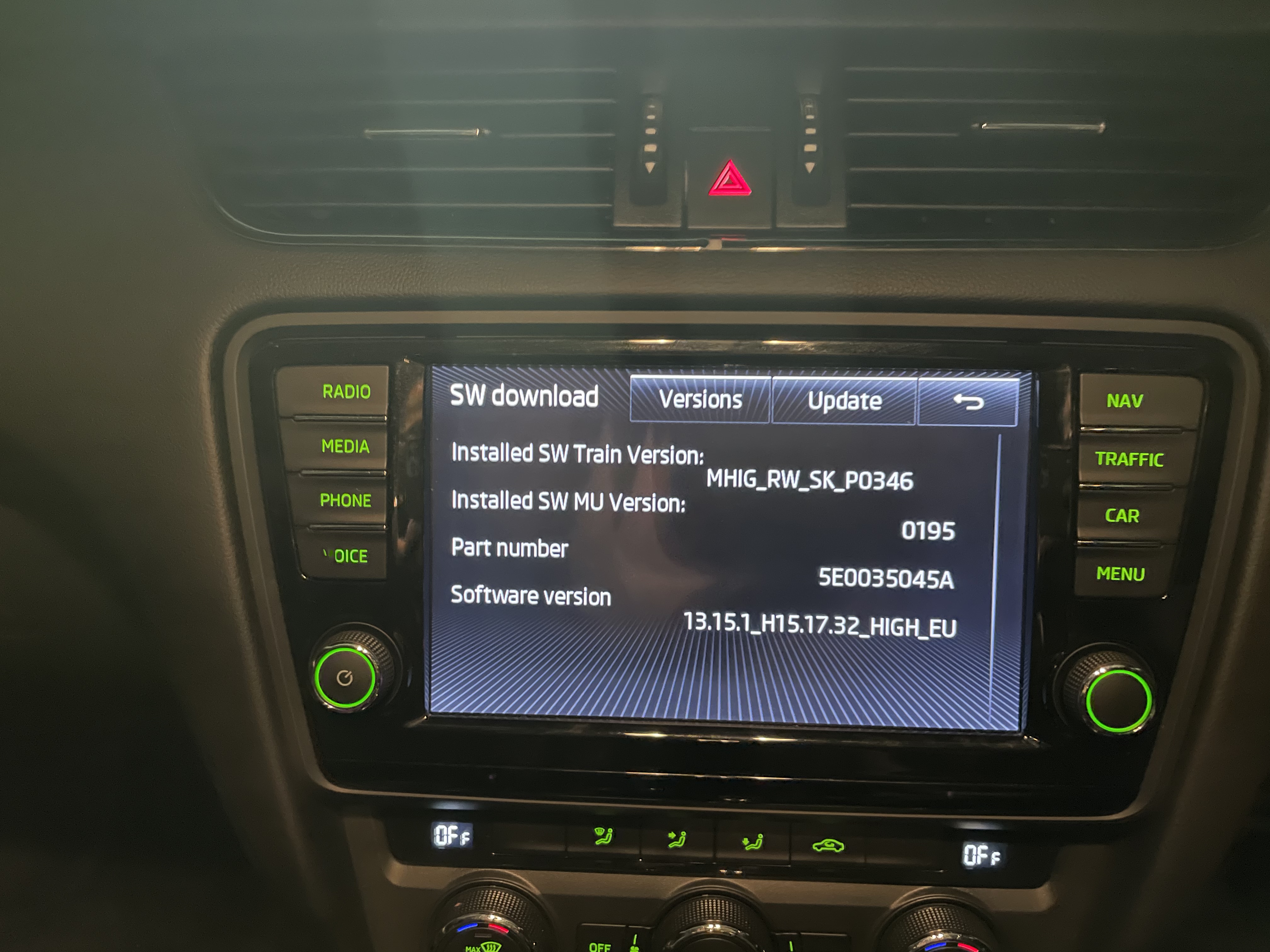

Ok thank you so much could you please help me out and send me the right directions I have been looking for a dealership near my place but no one can help me out, I currently have this thank you
I shall send you a link to update this to 0412

Hi @varooom
I have the same issue. would you please be able to share the link to 0412 as well please. I have the SW Train Version:  MHIG_RW_SK_P1055
Thank you
