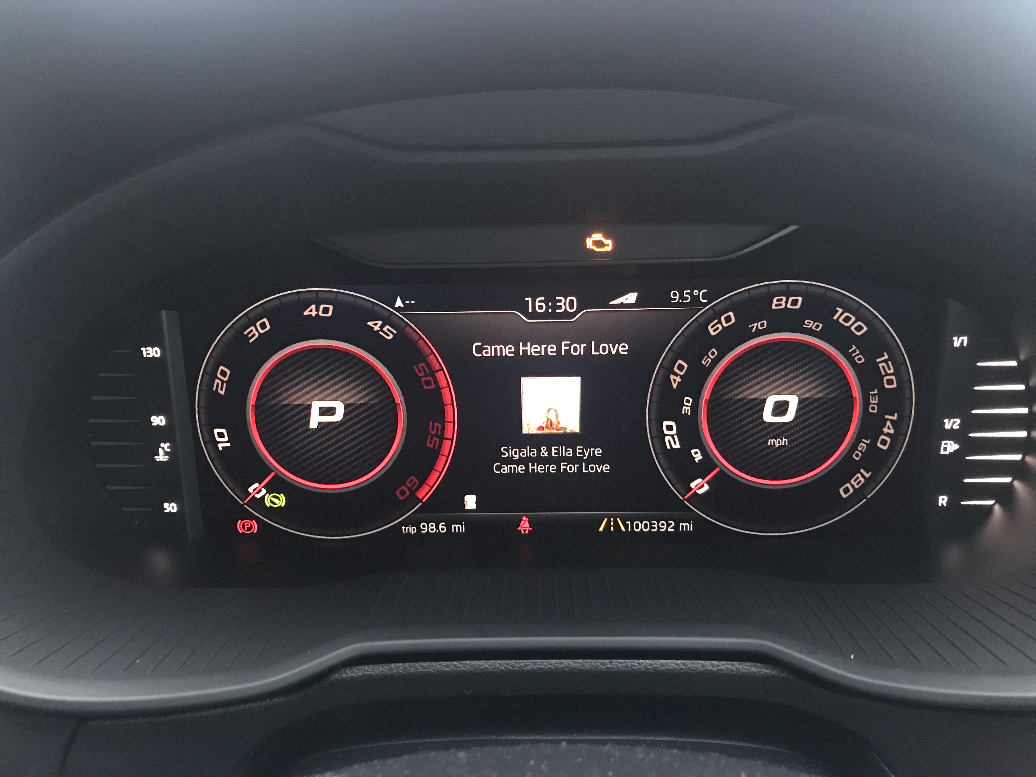

A cool one for the VC is to code 10 mph increments and my speedo also runs to 180 instead of 160.
Can’t remember the coding for this, it’s in 17 Instruments under adaptations, but I can’t remember where I found it!!

Yes I have the virtual cockpit. Which as you know I'm not a fan of.
