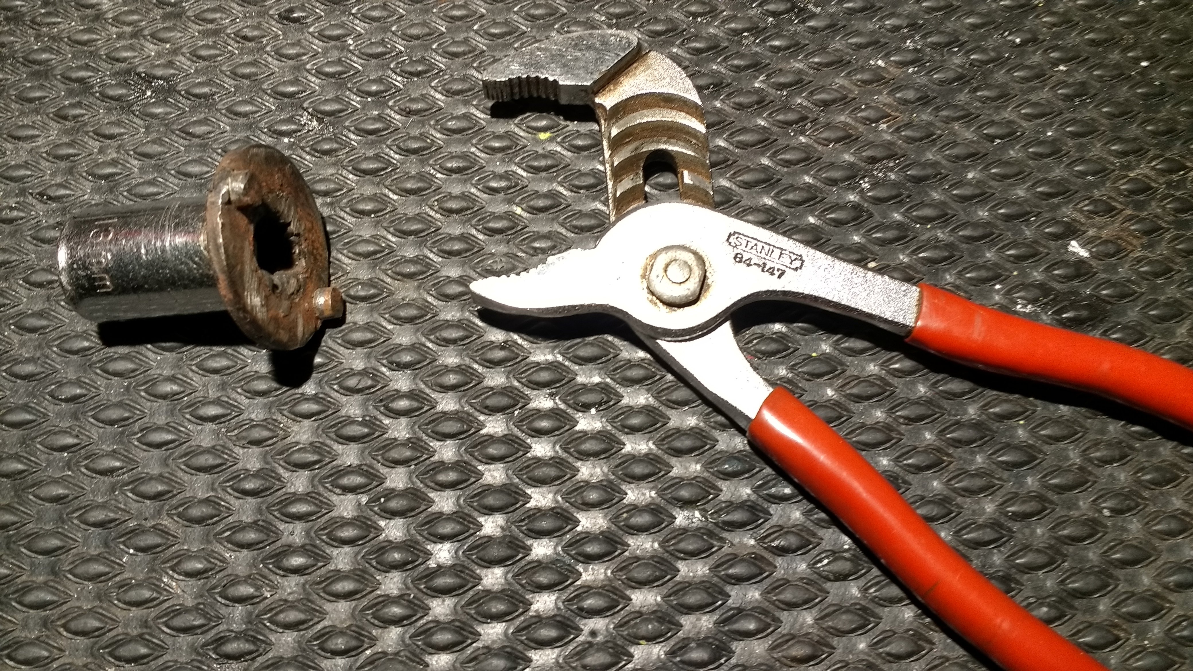

I didn't like the proper tool for some reason so made my own from an old socket, washer and nail.  Before that I used adjustable pliers, just takes a wee while to turn it bit by bit.
Just to clarify, the DIY tool is turned easily by hand from a ratchet extension as the socket still has the ½" drive. If it was tight enough to warrant a ratchet to turn then the thing needs attention.
The adjustable pliers were just for show as another option and not the means of turning the DIY tool.
