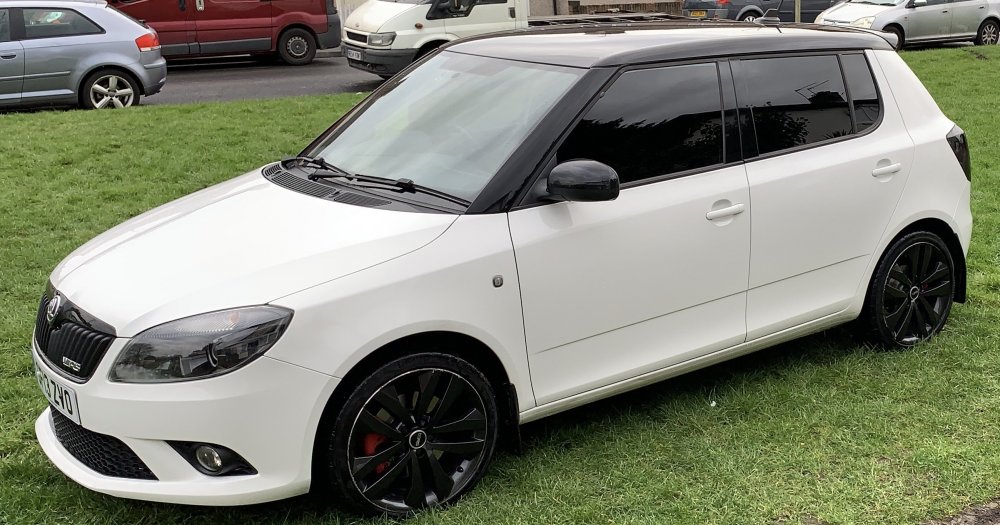

i own a Skoda Fabia Mk2 VRS 1.4 TSI. Im thinking of doing various mods including Stage 1 possibly 2 upgrades, ive got a straight pipe cat back already, my next mod would be lowering the car. I live in London so naturally tons of humps pot holes etc, i want comfort but mainly aesthetic look to lower it. From what i gather springs are good but will bounce the car like a bouncy castle and coilovers would be better. How can i judge how many mm i would need to lower the car. Ive attached a picture which shows a massive gap between the rear tyre in particular and the arch of the cars 1C811326-7AA0-4693-919D-19C996FA8658.thumb.jpeg.8a68dde9d659234dcffd5679b5124bf1.jpegbody. My aim is to completely remove this gap, i dont want the car sitting on the tyre but a 1mm gap i wouldnt be too fussed about. I have a clip on youtube of my car under the channel ‘Cars and More’. The guy is a known youtuber that does reviews and has a Vrs himself. Feel free to check it out. Any advice help or guidance would be much appreciated. I am new and not very familiar with cars that much, so please go easy on me

H&R 40mm are good i use mine on track and they have been fine.
