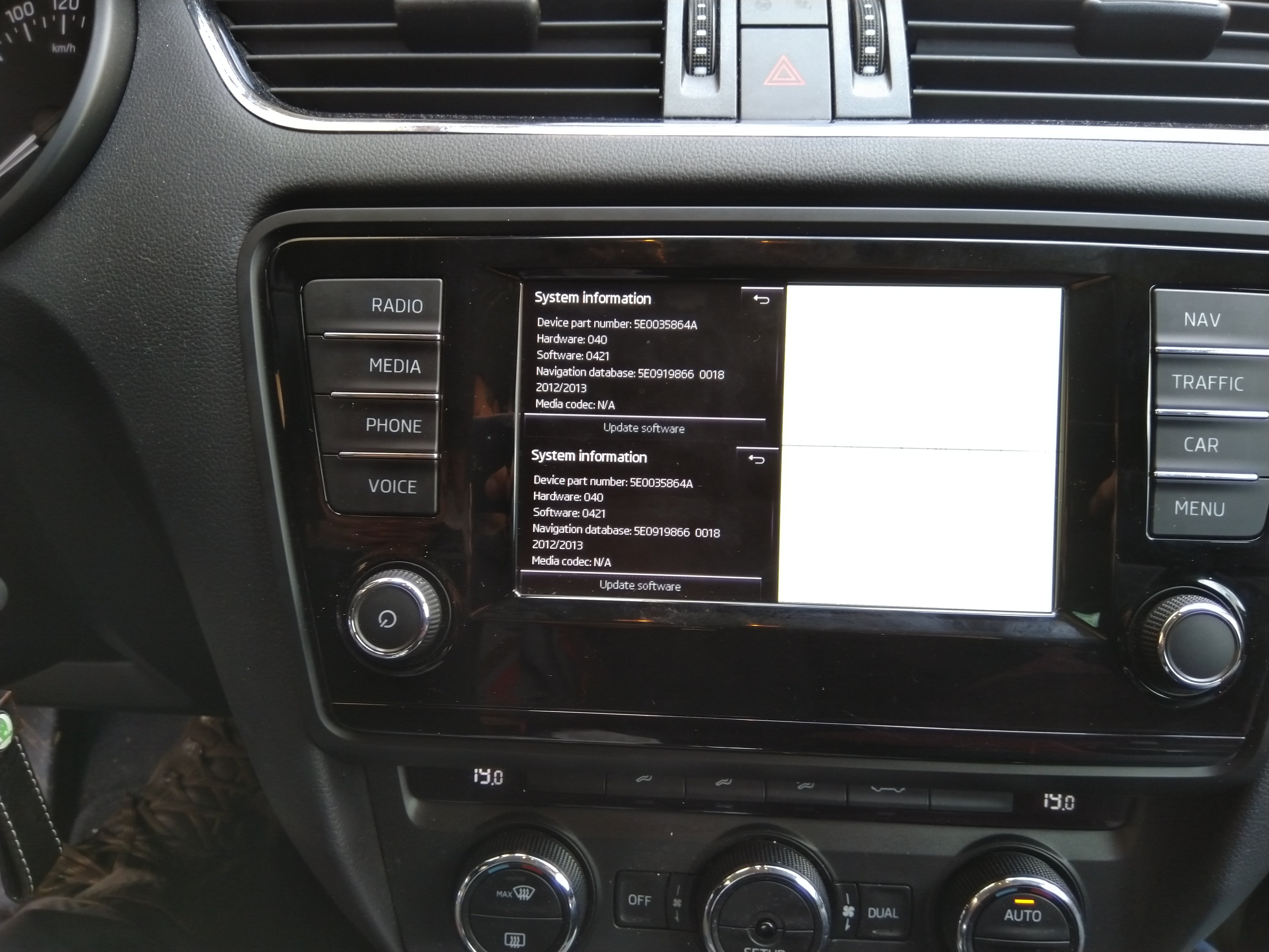

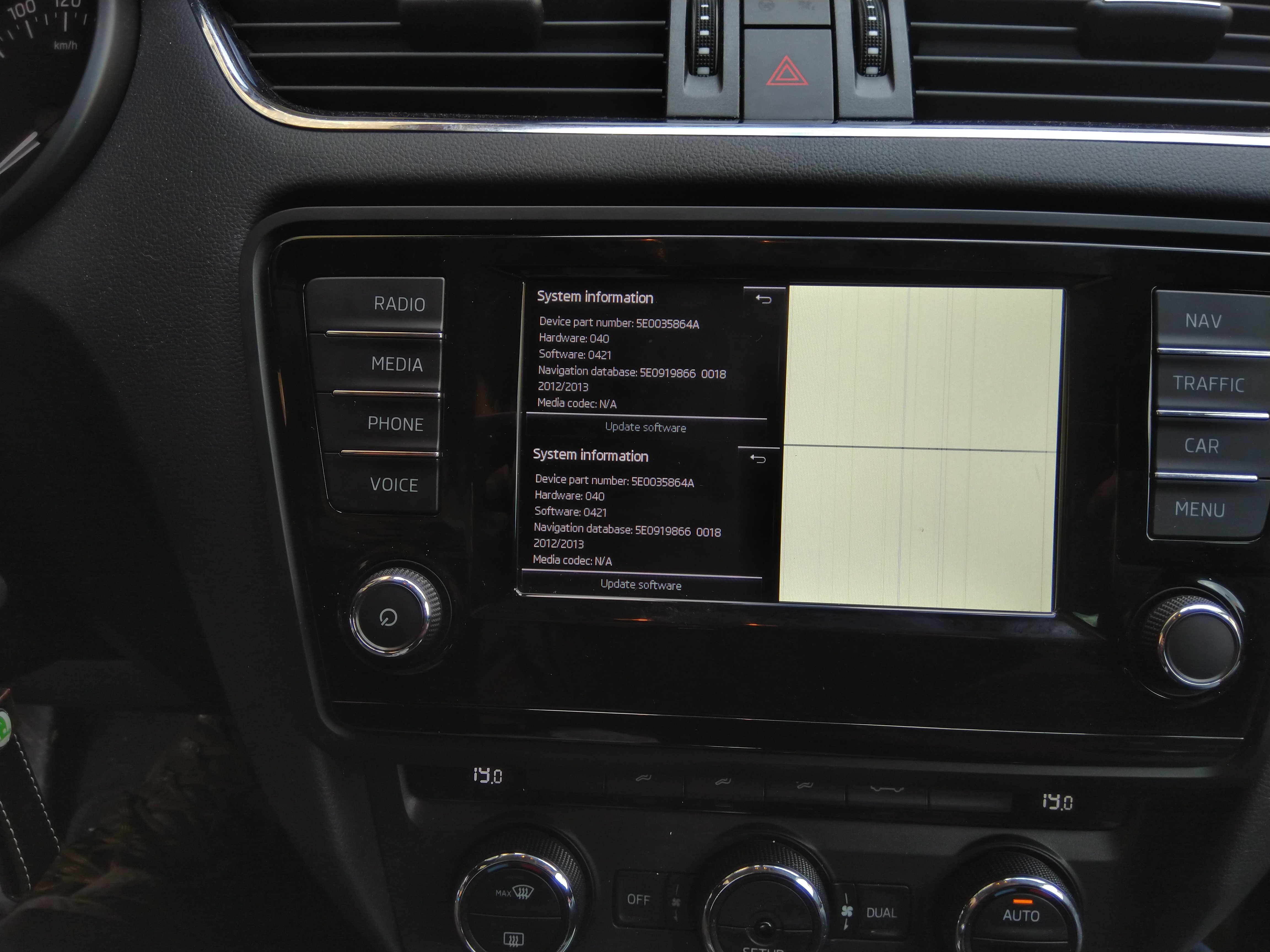

Hy. Im new on forum, can please someone help me, I have problem with installing new Amundsen, Its from 2015 year and I have a 2014... Any advice why is showing that? Thanks for help.
Looks like you may have fitted a mib2 box with mib1 screen or the other way round. When you change to mib2 you have to do both screen and unit in the glovebox.
