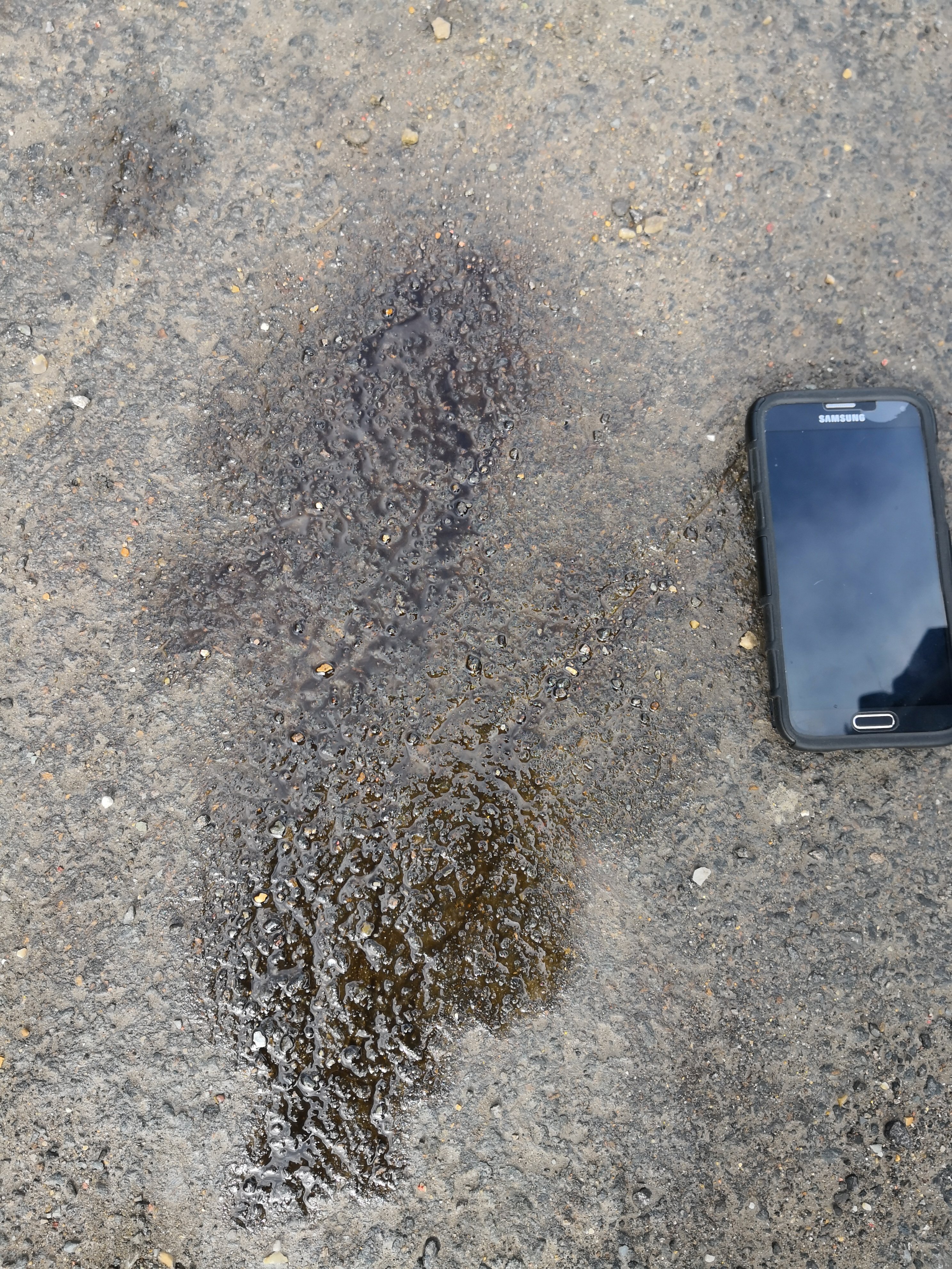

Seems the car has an oil leak because there appears to be quite a bit of oil underneath the car from where it was standing for 3 hours. and oil level was well below minimum on the dipstick.

Missed picture
Update
Engine is shot. No compression with rods, pistons, etc, bent, broken or in the wind place. Mechanic thinks leaking oil and inherent design issues caused timing chain to slip and cause mayhem in the engine.
Next step - 3.5k to rebuild engine but given the car is on 125k scrap is the sensible solution.
