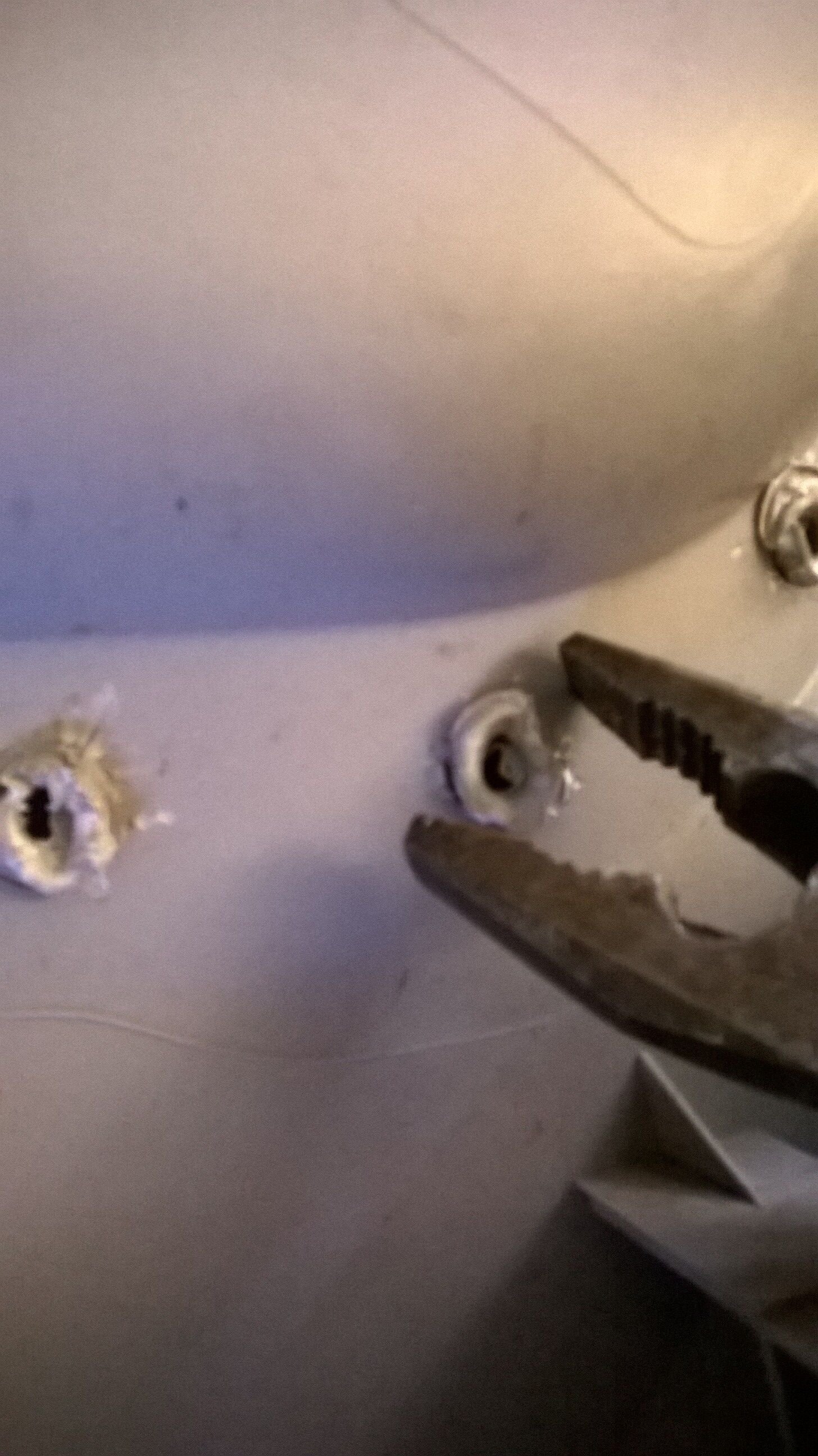

Solution is to buy cheap tatty scrap door trims from a higher model and take the pockets off.The pocket has extensions that go through holes in the trim and are melted over at the back to fix. Squeeze them in with pliers and the pocket will pull off.

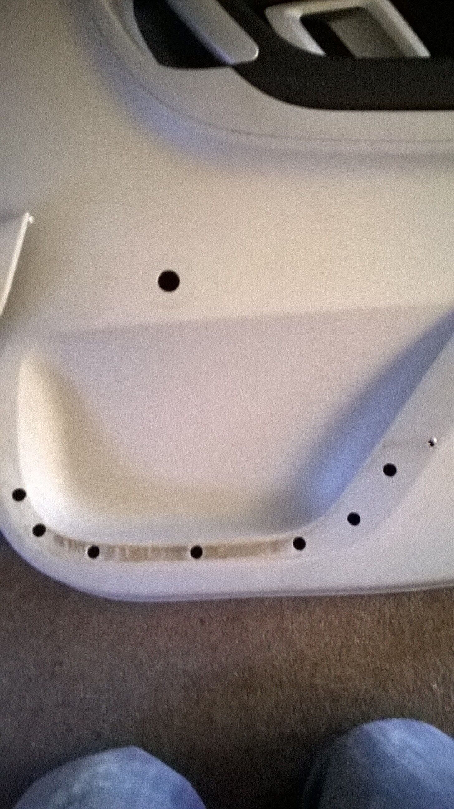

This leaves the scrap trim looking like below

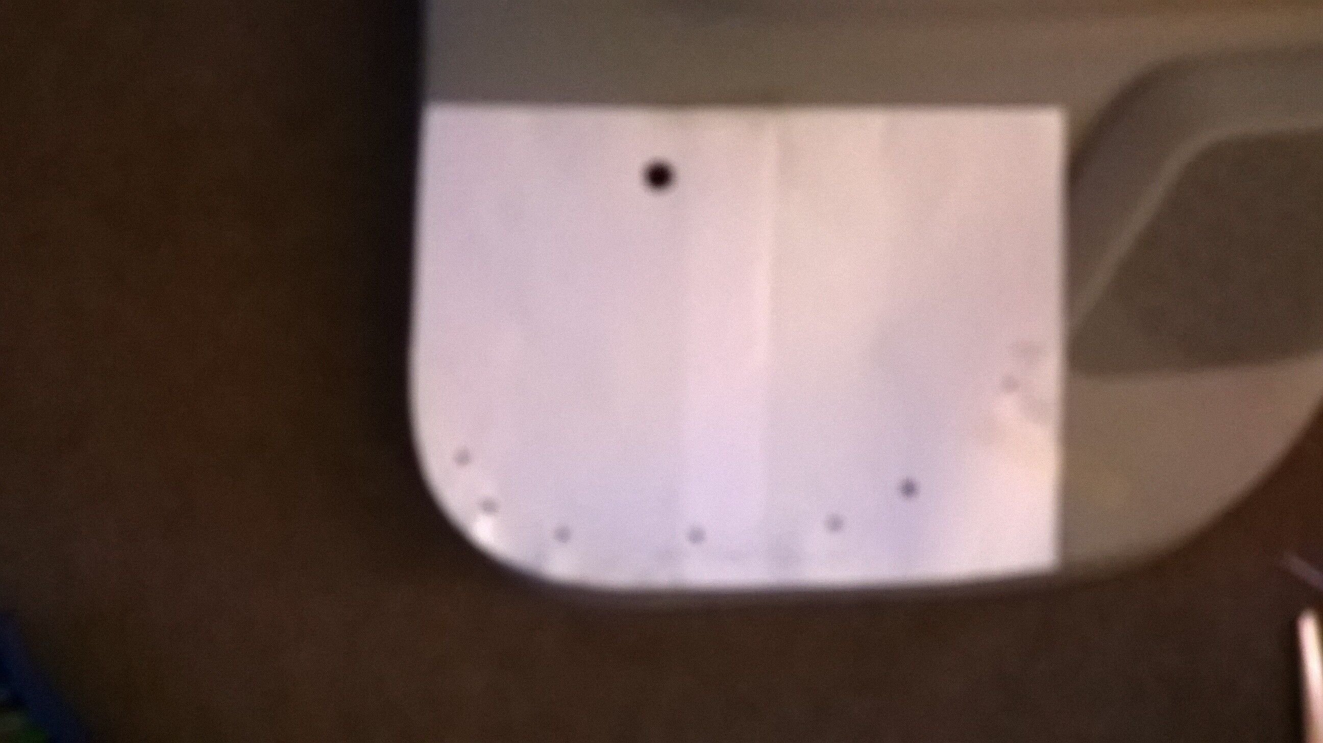

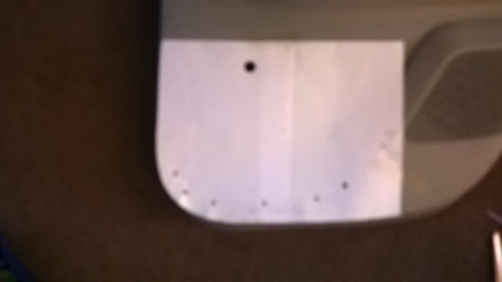

Make a paper template to match the holes and transfer it to your own door trim.
Drill the door trim out according to the template and offer up the door pocket . You may have to do a bit of extra drilling out and fiddling to get it to match up. Then return to the rear and fix with self tappers through the holes. I found 1/2'' No.14 worked fine.

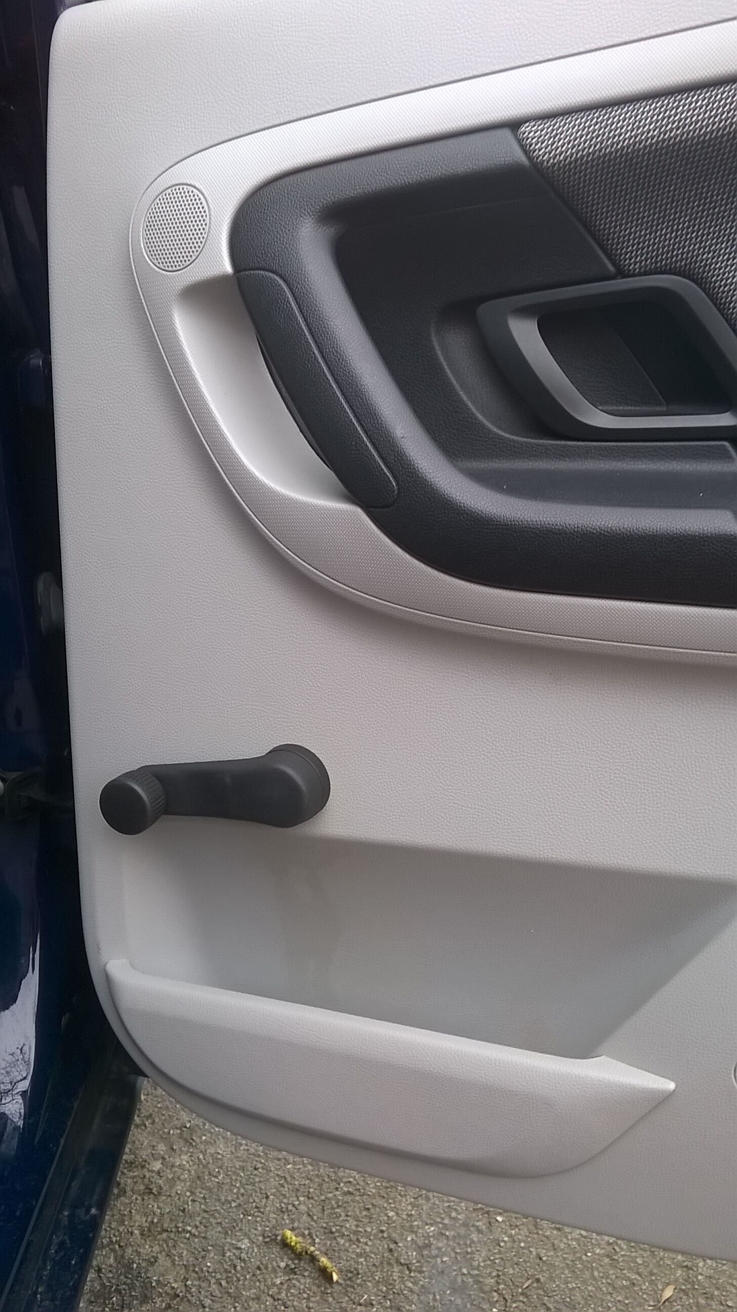

Finished result.
Quite a lot of work for a couple of little pockets maybe . Does finish the door off and gives a bit of storage.
