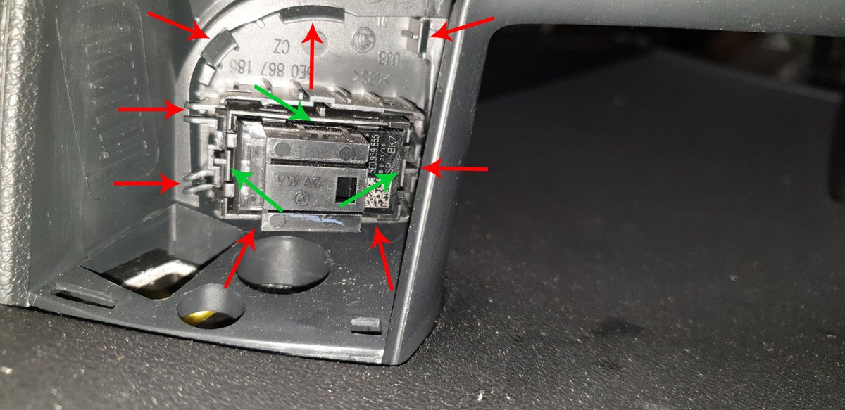

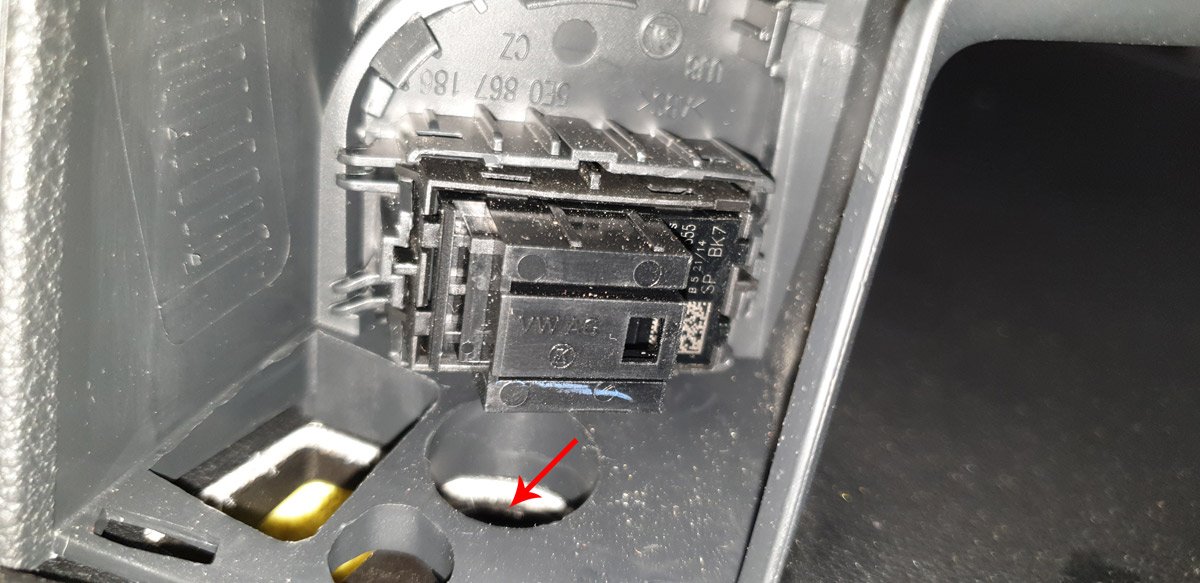

You have to remove the switch to get at the torx if you want to remove the door card so i got that back to front sorry, its been a while since i took it off.
the torx for the door card removal is here...
red arrows are the clips for the surround which i found really tricky to remove without damaging them.... and green are the clips for the switch itself which just required a flat trim tool to pop out...
Thanks for that! Thats a really big help. I'm gonna do it tomorrow afternoon and I'll update you on how it goes.
So today I fitted my window switch. I took my door card off and did it according to the pictures. It was a fiddly job, but i got there in the end. I did manage to scratch the door card a bit, and one of the clips for the surround cracked. But its all fitted now and the switch is working. Once again, Thank you for the help and the pictures. I really do appreciate it!
