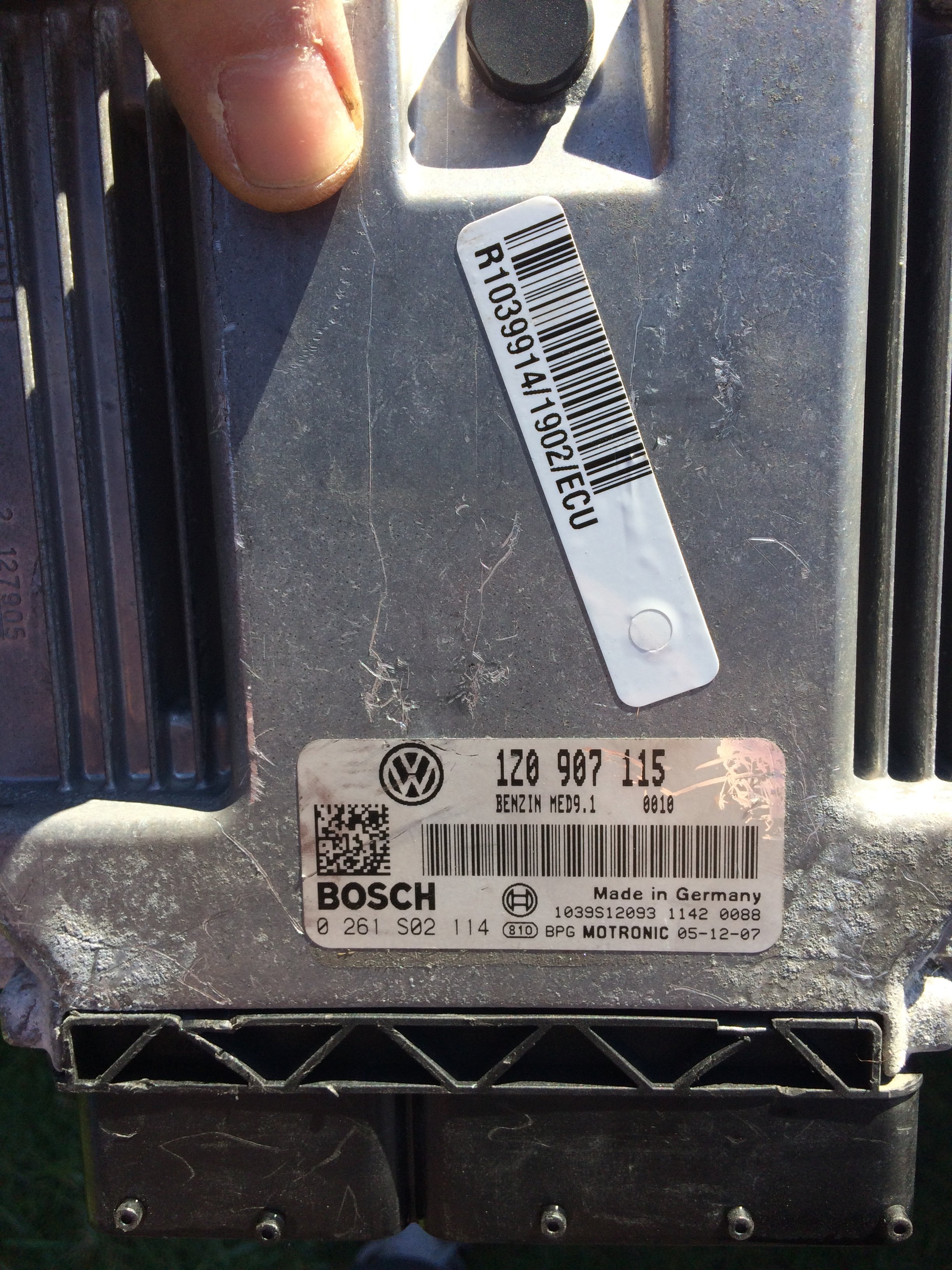

If I were you, I'd get the ECU checked again as there is nothing to say it was checked properly or is still undamaged.
Assuming it's good, start inspecting/verifying the wiring against the official WD. Continuity is not enough, you need to load test the wires using suitable tools. Even more so as there are reports of water damage around the ECU connector, it's certainly possible that the water has wicked down the wires causing corrosion.

You should also post a full VCDS autoscan and confirm the ECU has been updated to the latest software version.
