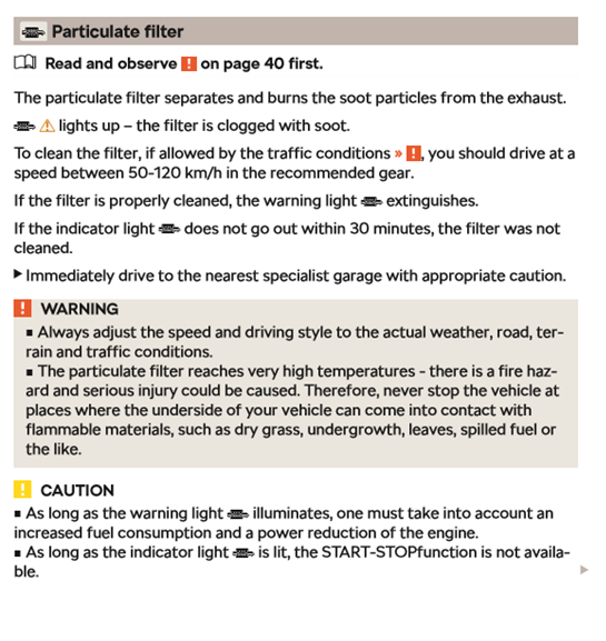

Error flashed up, 15 mins on the motorway the error cleared its self.
Sounds like both you and the car did exactly the right thing. From the manual:
