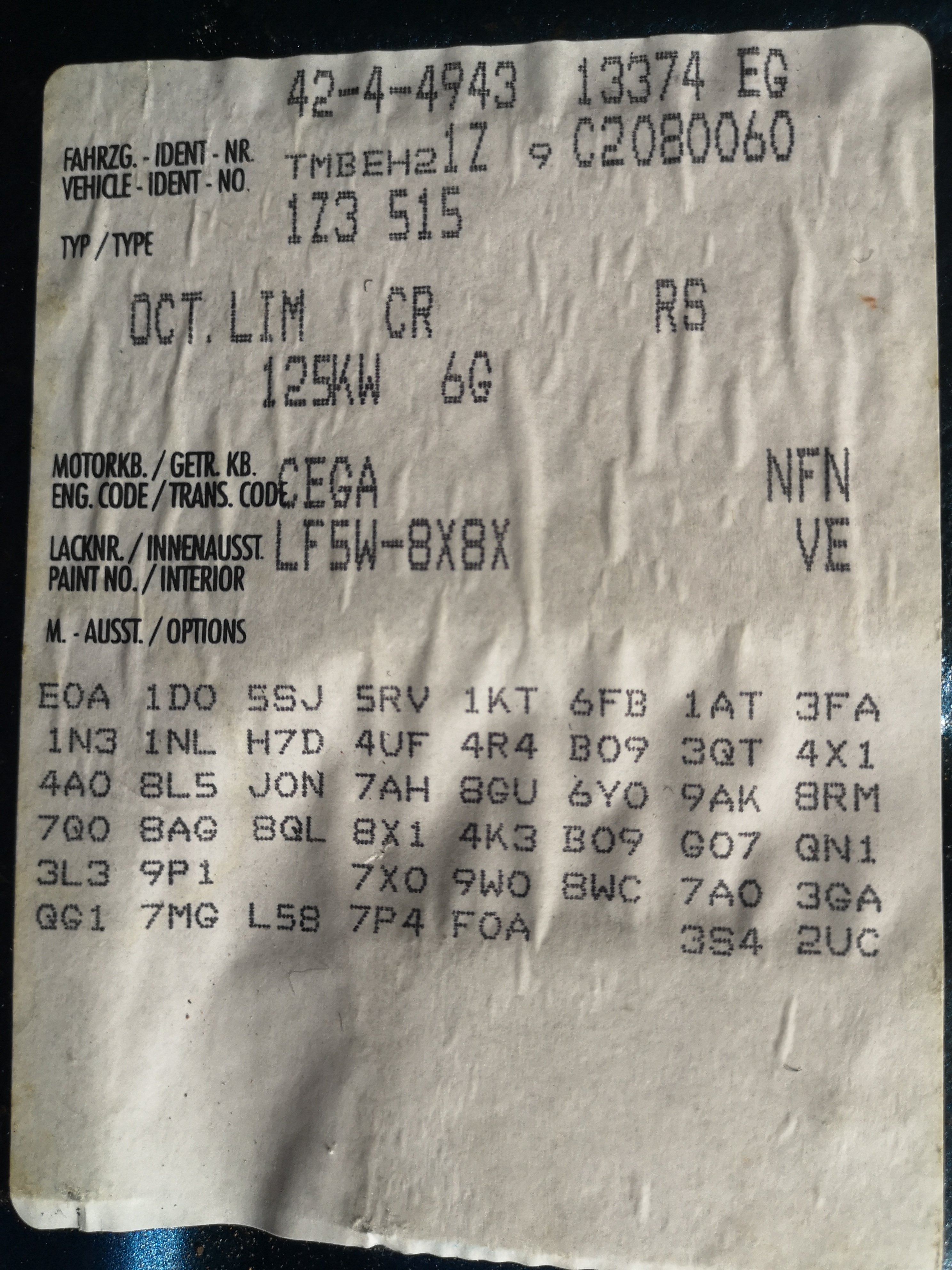

Hi all
I want to take advantage of the Euro car parts sale and invest in some Pagid discs and pads front & rear.
I'm not sure if the sizes are 312 and 272 as there are different variants apparently between models.
Could someone be so kind enough to clarify by looking at the boot sticker please?
I'm not sure what exactly to match up and any help would be really appreciated.

MIne are 312 and 272 on the rear. Yours are the same, the link you posted are the correct size discs.

1KT is the code for rear discs

Unfortunately the space on the second to last row is the missing PR code for the front discs. Not sure why they're always missing.
Put your VIN in here and all will be revealed...
Thanks for linking that massively helpful. Ok, seems the missing code is 1ZB which ironically, isn't listed on euro car parts.
Haven't had a chance to remove wheel yet that may be my only option.
No idea what size that code pertains to :blink:

Being thick now it's 1ZB not izb
Ahh right ok that seems a bit more clearer now.

vRS fronts are always 312mm and the pad never changes.
Rear is more of a lucky dip and needs measurent.  Several types of caliper / pad too.
