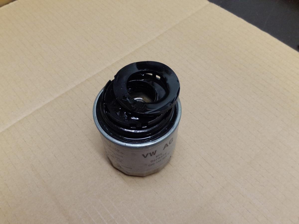

When you changed the oil filter, did you make sure the large rubber seal that sits in the bottom of the filter came out with the filter? Very often it gets left behind and it can be missed because its under the black oil in the housing, so you have to fish it out.
If you left it in, you have 2 sealing rings and the oil filter is not fully fitted and you will have very low oil pressure and flow. Could be the cause of the constant rattle

Also seen that I looked on the filer housing and it all seems to be sat flush, would it be noticable without removing the filter? In all honesty I didn't even look at the old filter, how big is the rubber seal and would it be noticable after installation
No, its not noticeable, you need to remove the filter to check. Look at the pictures here....
