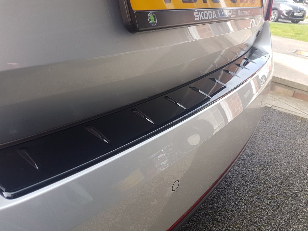

Here's mine on a hatch
Cheers, that wouldn't cover the damage on mine though I'm afraid.

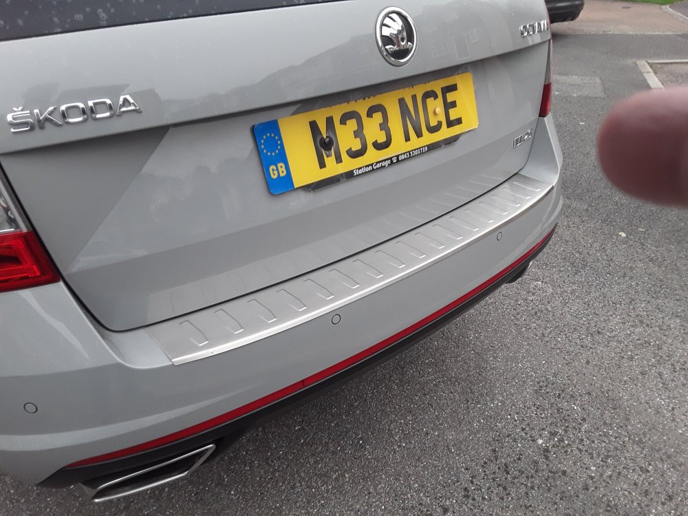

Here's the replacement fitted, apologies for my finger appearing, i rushed as it was raining.

Looks great, where did you get it?
Time for a new number plate, water ingress from the top and stress discolouration around the screws, it detracts from what looks to be a very tidy car.
