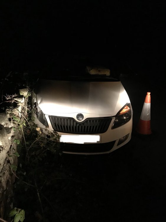

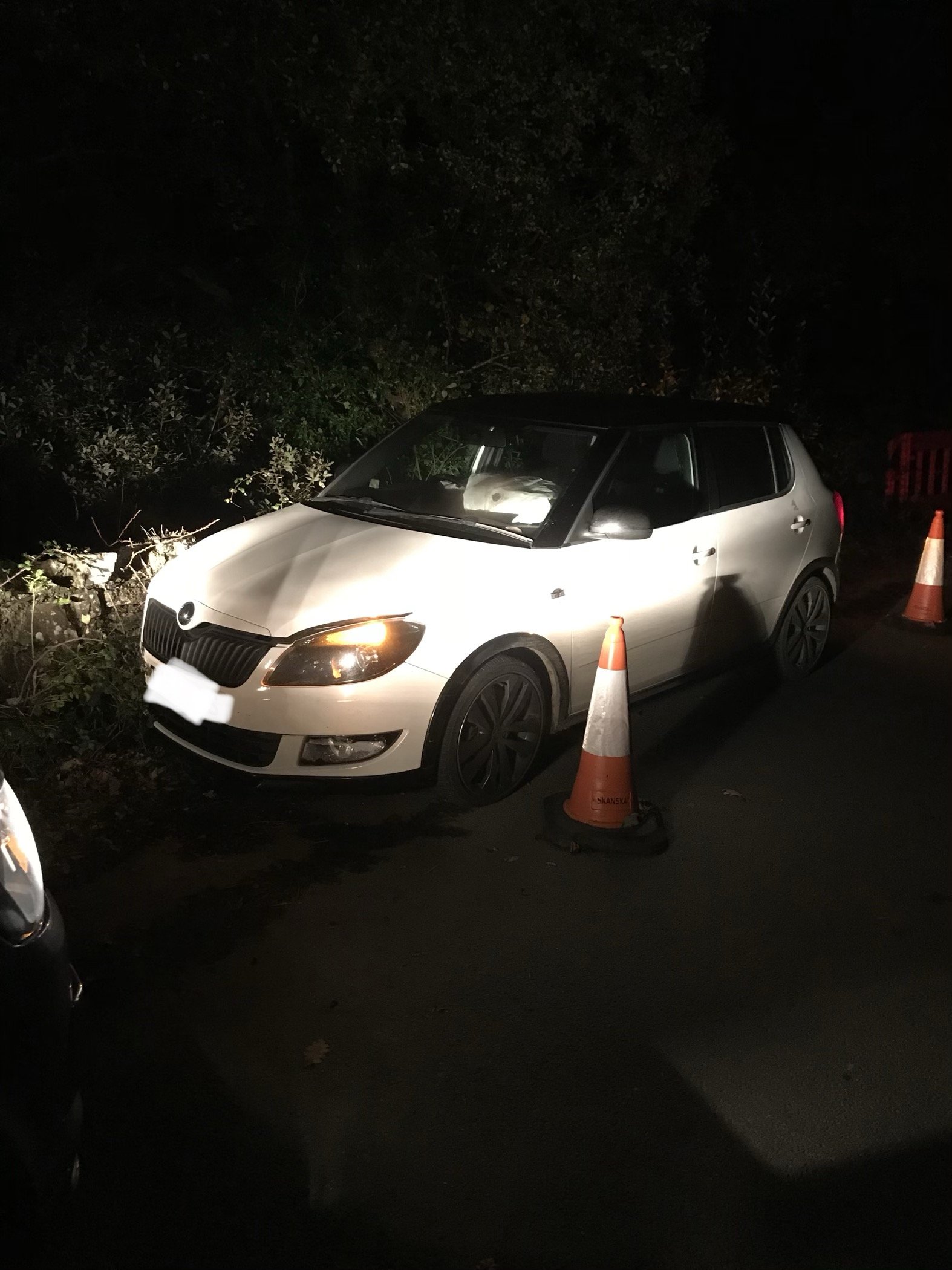

So this is my first car, I had it for just under 2 years until I wrote it off into a wall. I loved this car so much I decided to buy it back off the insurance and repair it myself, upgrading along the way.

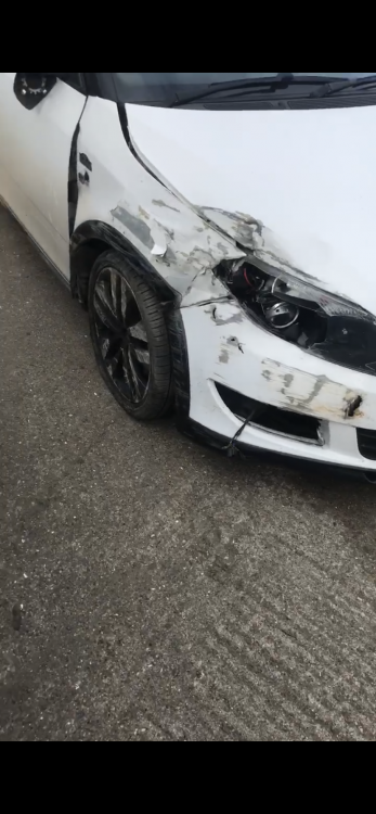

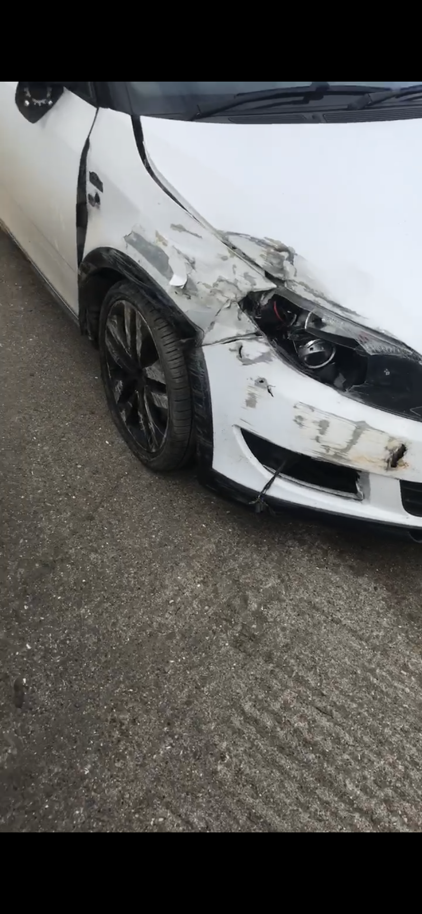

List of damaged parts:
front chassis legs
Both head lights
Both fogs
bonnet
front bumper
front splitter
offside wing
offside brake disk (the bottom arm popped out of its joint and went straight through the disk)
offside bottom arm
offside driveshaft
offside steering arm
offside strut and knuckle
aircon pipes
drive belt
Divers steering wheel and seat side air bag
passenger airbag
bent rear axle
2 offside alloys

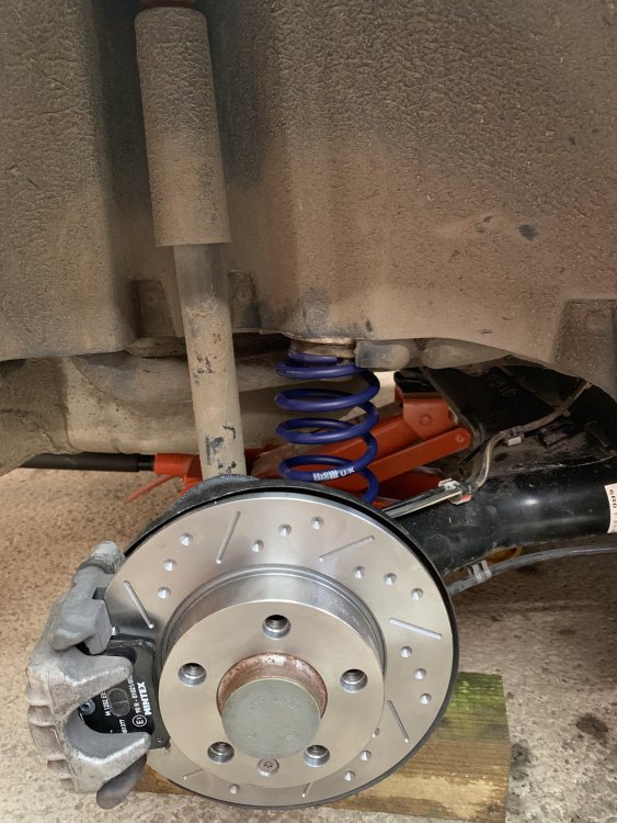

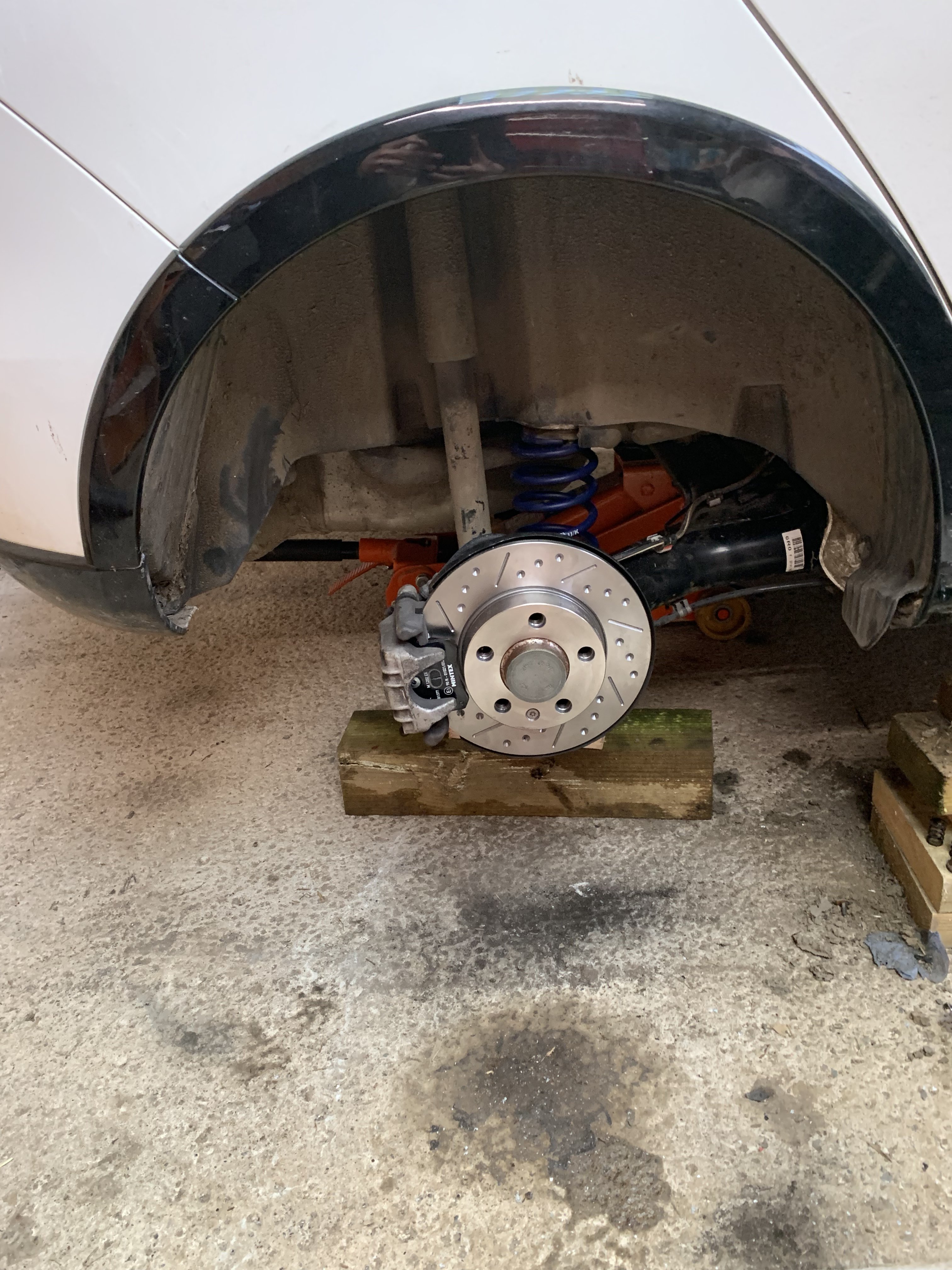

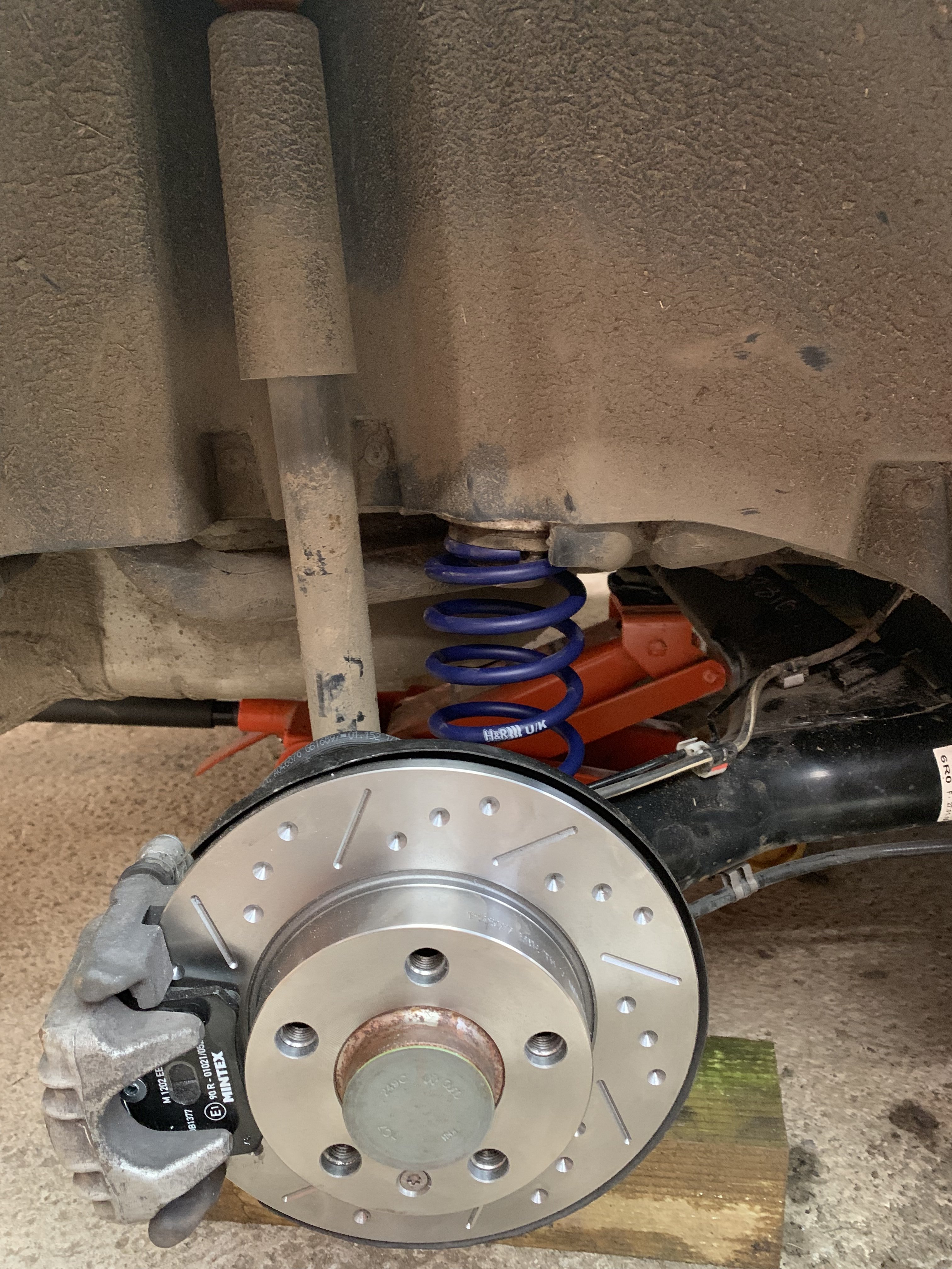

I started off with replacing the rear axle. These come standard with drum brakes which I think look a bit crap, so knowing that the Audi A1 (which has disks on the back) was on the same chassis as the Monte I took some measurements and made sure an A1 axel would fit and sure enough everything matched up.
When it came to installing, it was as easy as slotting it up and bolting it in. I replaced the stock disks and pads with Mintex drilled and grooved disks and pads. This is an awesome and easy upgrade and I would highly recommend.
While I had the axle hanging down I bought some h&r 40mm lowering springs to install.
