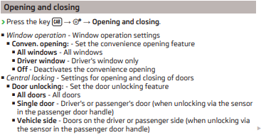

I think you change the locking option in the settings menu under convenience?
Its under the following:
Problem is, after having it set on "Single door", a large percentage of the time it still unlocks all doors on my car.
