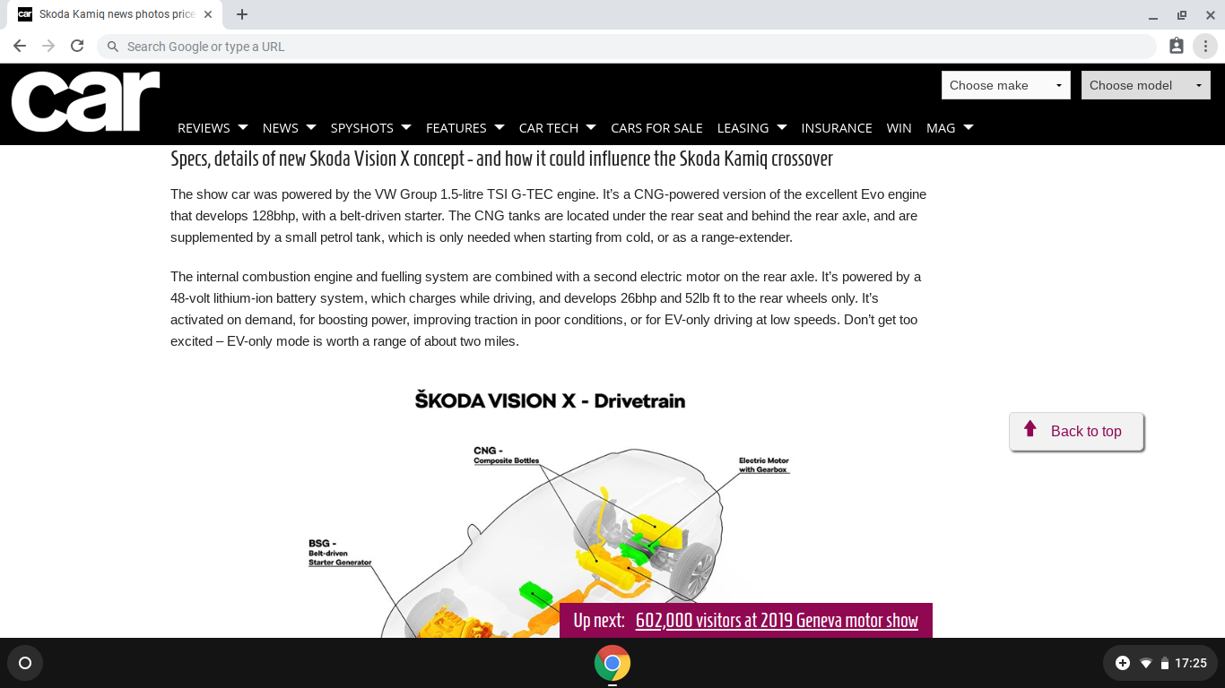

Skoda say they will be doing future models with CNG Engines, so you would imagine SEAT will.
It seems that currently the issue is not the ACT, instead engine injection. Some dealers are working on it and very soon, there will be a kit for our models. For me its not a problem because my warranty is 4 years (or 60000km) so I can wait for it.
