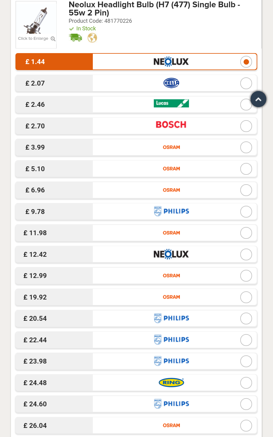

You can spend up to £27 for a pair of OSRAM Nightbreaker Next Gen H7 but having tried Night breakers before I found that Neolux H7 bulbs for £3 a pair perfectly adequate and only marginally worse.
Please understand all H7 55w bulbs are the same brightness (by law they are limited to 1500 lm iirc). Upgrade bulbs use a shorter filament positioned in a slightly different way and run hotter, so appear whiter and optically push the "hot spot" further down the road, an optical tweak. The downside is they have much shorter life than a standard bulb
Neolux is owned by Osram and is their value brand. The £1.44 version is equivalent to their standard bulb as fitted OE to your car. Same specs. lumens, bulb life etc
