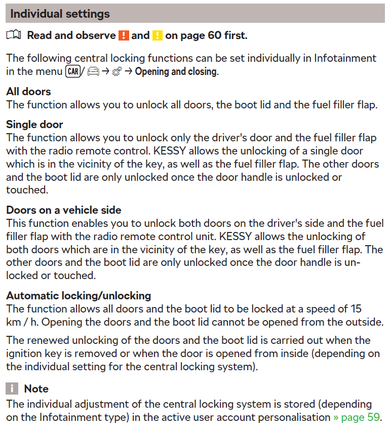

Do they unlock if you press the open button twice?
If so then look in the infotainment settings to change the personalisation.

It’s a setting you can change. Mine did that, but changed it on the display to open all doors with one click
