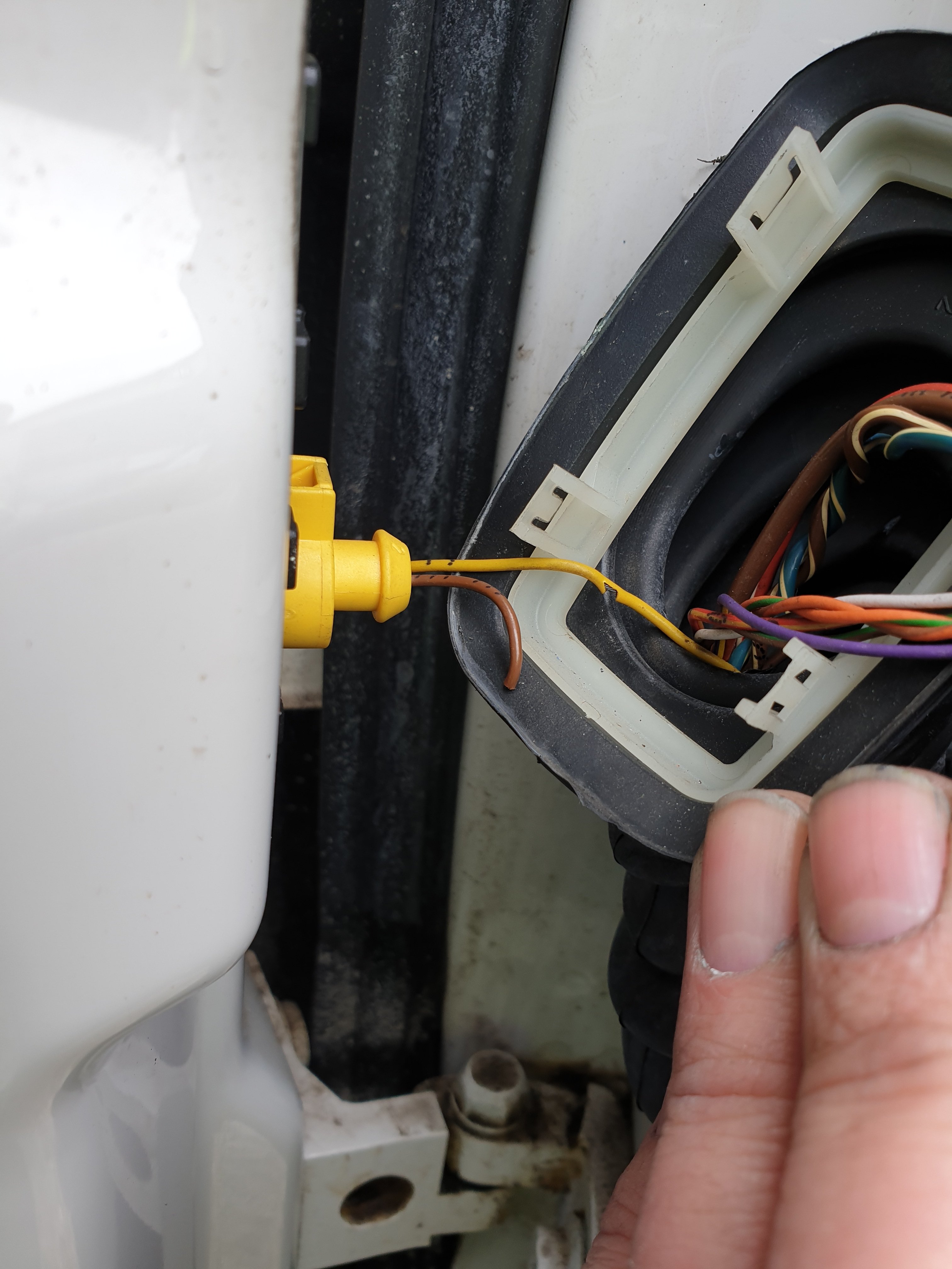

Hi all,I've seen same problem on here already, just need to no the location of the sensor_ is it in door,pillar between doors under seat? Just while I'm pulling carpets up checking wiring and connectors. Skoda Octavia 2012 vrs.fault code.04C5 drivers side impact sensor .Thanks.
No replies but sorted it anyway.snapped wire from car to drivers door.brown wire snapped behind rubber boot.
