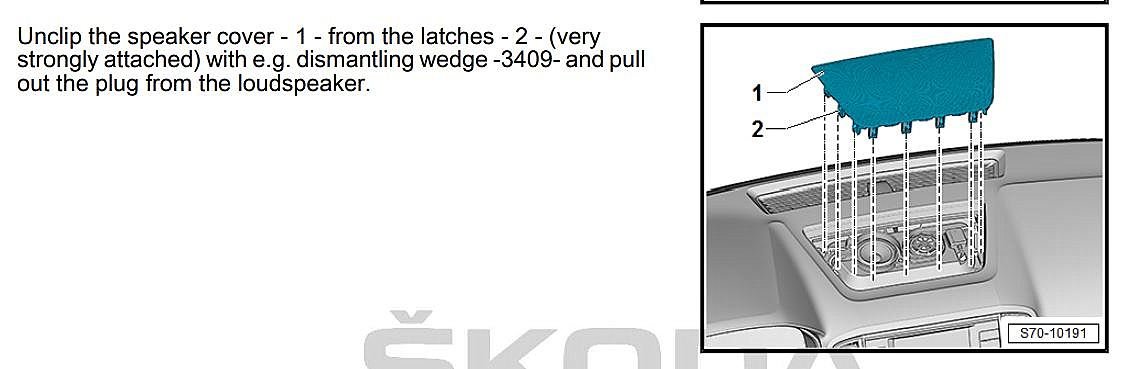

Has anyone with the Canton speaker system disconnected the centre dashboard speaker? I think it adds too much middle frequencies to the sound and narrows the stereo image. Is it possible to prize off the top grill to disconnect the speaker? Has anyone done this successfully? And will it cause any problems for the amp regarding total speaker impedance? Thanks.
From the workshop guide kindly provided by Arkaig......
Thank you!

I don’t have Canton, but I find setting SOUND FOCUS to DRIVER (from ALL AREAS, which is default) makes quite a difference in sound perception. At least from drivers seat;)
