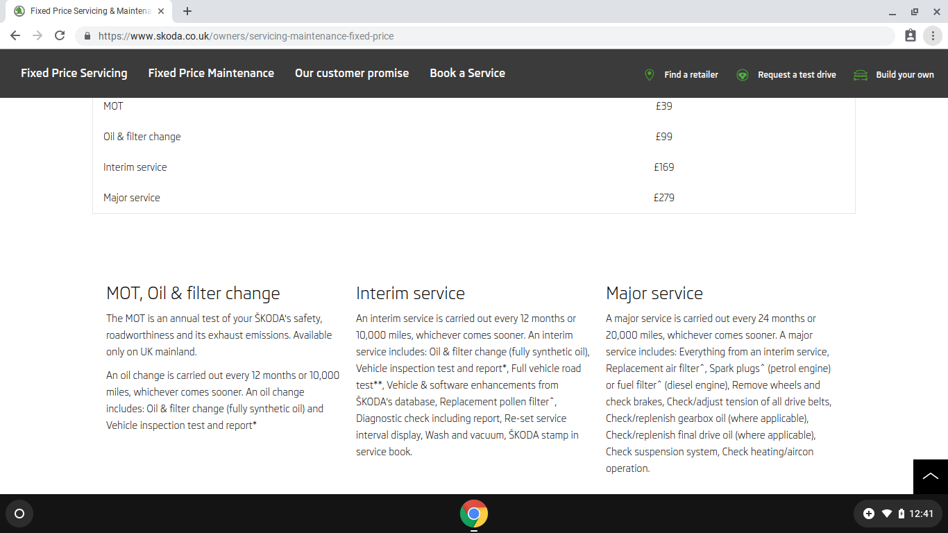

Pity it can not just be a Oil Service & MOT for £99 that Skoda Fixed Price @ Participating Dealers offer.  But that is 3-10 year old cars.
Maybe ask for that though.
