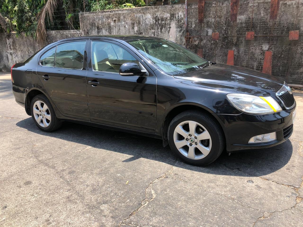

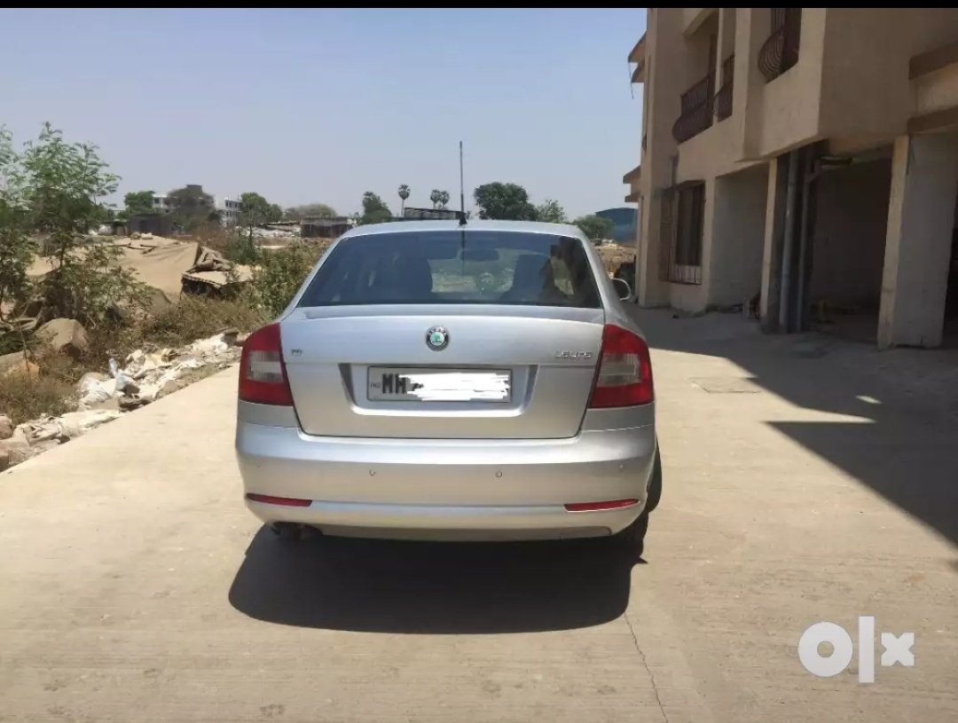

I am in the process of finalising a 2010 1.9PD Laura (In India, Octavia II elsewhere).
Was wondering if it's a good buy?
It has run 70000 kms and is in immaculate condition (Atleast from the pics)
Anything specific I have to look for?

I think your view on 'immaculate' is different to mine. The Octavia in your pictures looks pretty rough, cosmetically.
The 1.9 PD engine is pretty tough, one of the toughest engines VAG ever made actually, the trade-off being that its pretty agricultural / noisey.
Not sure I'd be brave enough to buy a DSG version though, especially given the condition of the outside of the car. What's the service history, has the DSG gearbox ever had it's oil changed?

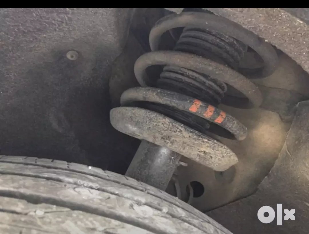

Is it 4x4? The rear suspension seems very high. Perhaps all Laura's destined for India got the Rough Road Package?

However, I checked the car today and yours observation is spot on! The car was in pretty bad shape. In fact, had been involved in a frontal collision and the repairs were shoddy to say the least. Needless to say, I walked away.

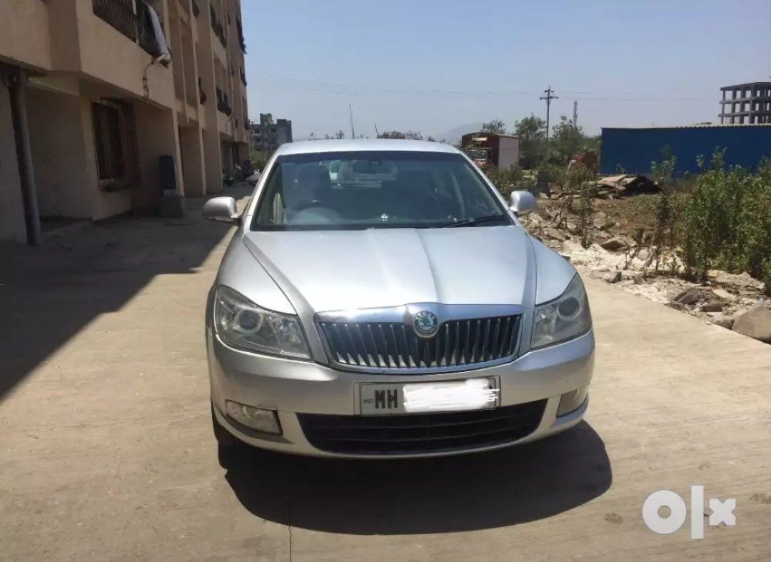

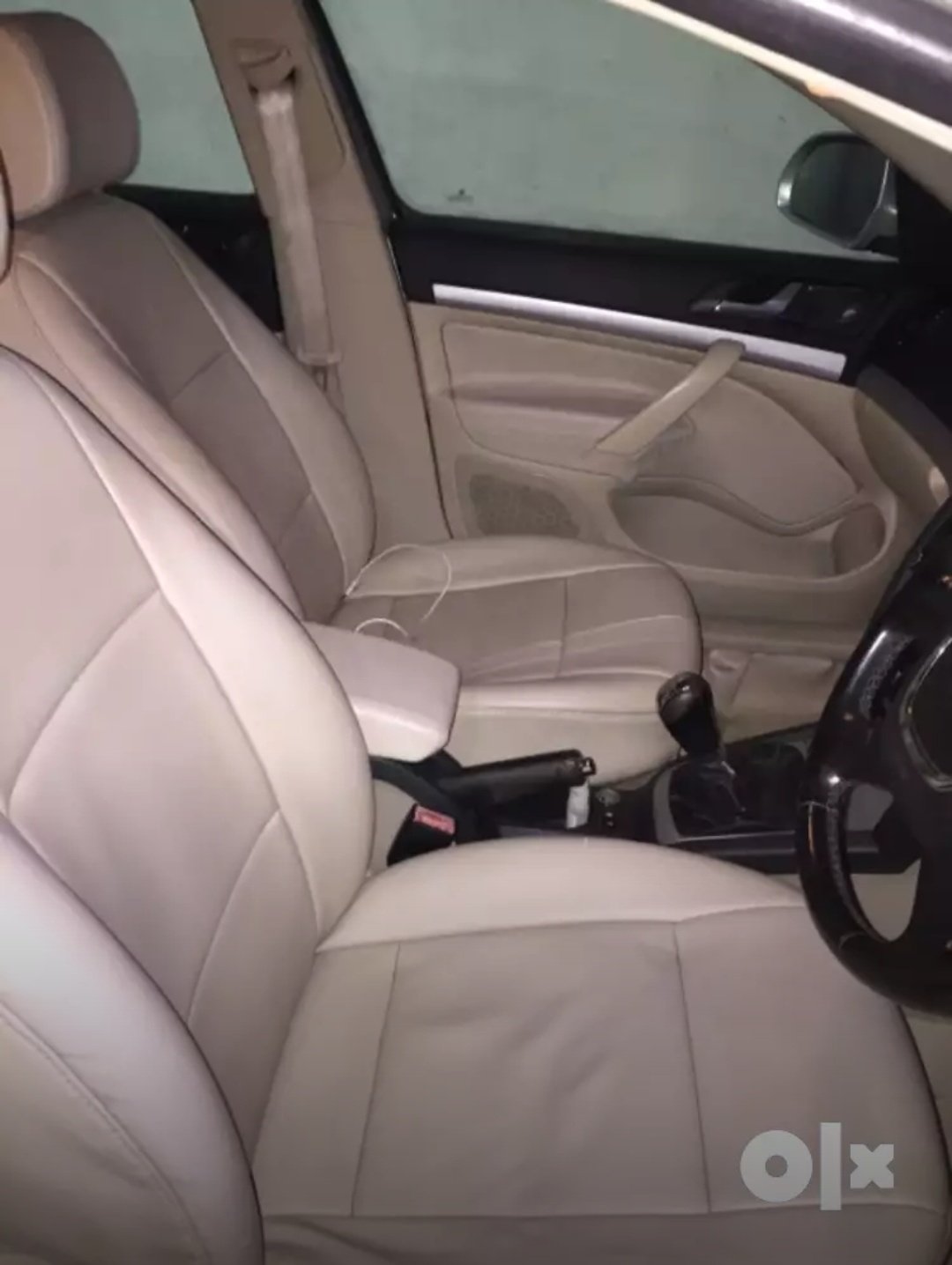

Now looking at this
2009, 5MT, diesel, the owner didn't mention the engine whether 1.9 or 2.0 but mostly 1.9PD.
Full service records.
Will check the car tomorrow.
Any heads up?
It's a 1.9 TDI PD105, you can tell by the twin down-turned exhaust tailpipes.
The idle engine speed seems high at 950rpm, unless the outside temperature is very cold and the engine isn't up to temperature, then it should be closer to 750rpm.

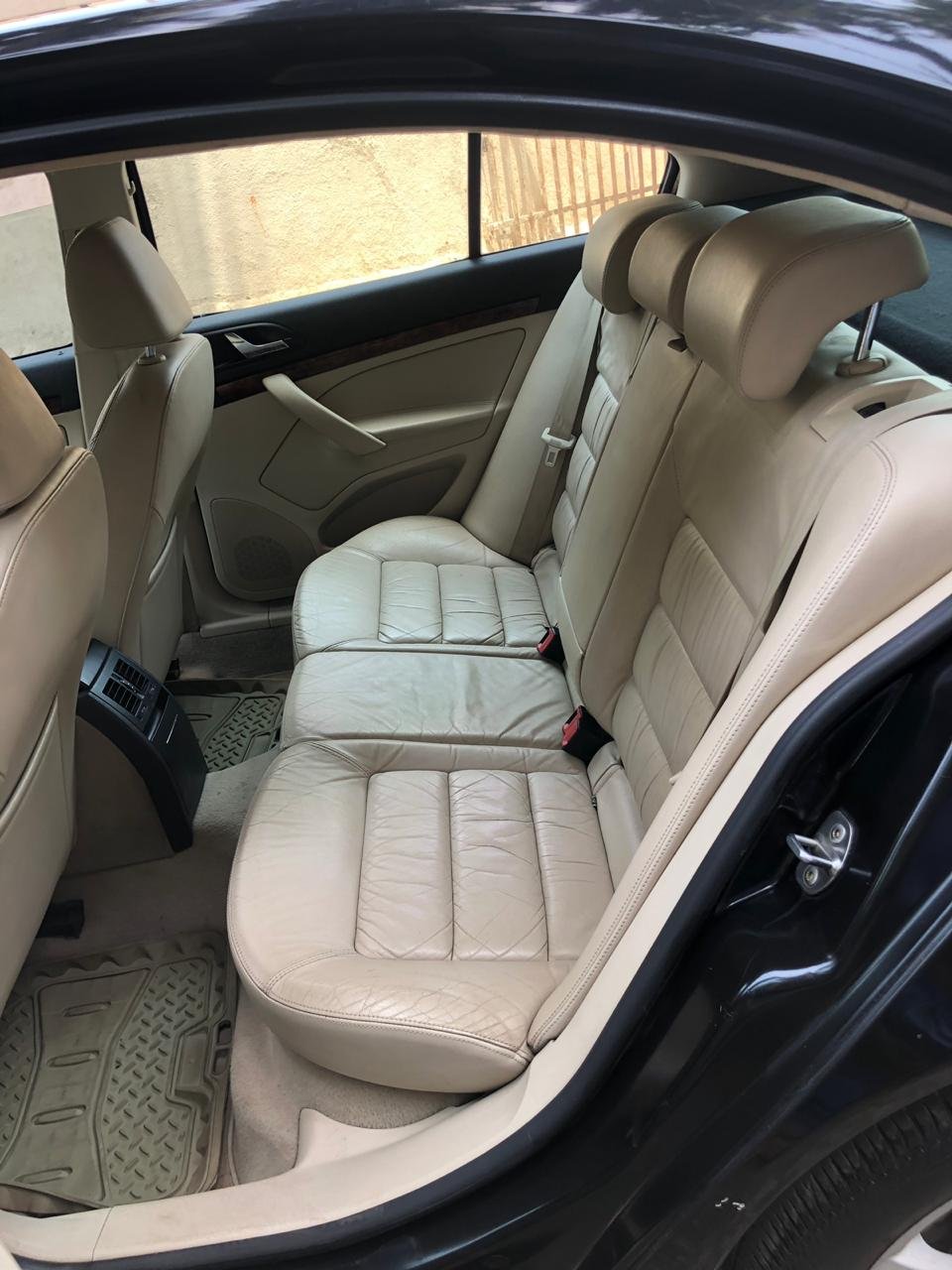

You like your light coloured interiors in India, the downside being that on older cars they look very grubby and detract from the appeal of the car.

Yes it is a 105bhp 1.9TDI Ambiente
Almost finalized
Interiors have all been changed and renewed.
All suspension changed
Steering linkages changed.
Drives good. No rattles or squeaks. No crashes.
But the torque is too low for my liking. Is it the characteristic of this engine or a fault with the car?
And what are your thoughts if I buy it and plan to use as my primary car for next 3-4 years?
Edited by muntaha
The PD105's torque comes all at once, a real shove in the back when the turbo is on song. Some people claim it is too abrupt.
The 'PD punch' was replaced with a much more linear torque curve when all diesel engines moved to CR (common rail).
If there's no shove of propulsion between 1,500 and 2,000 rpm under medium to hard acceleration then something is wrong.
I'd also be worried about the raised rpm at idle.
