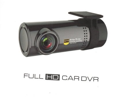

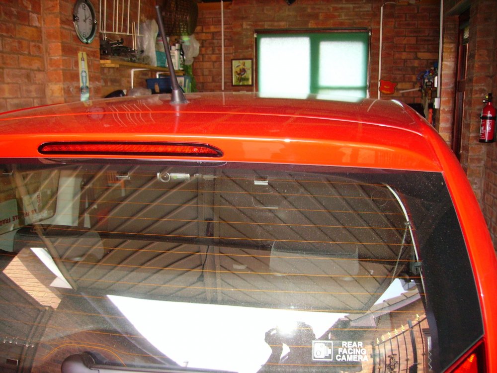

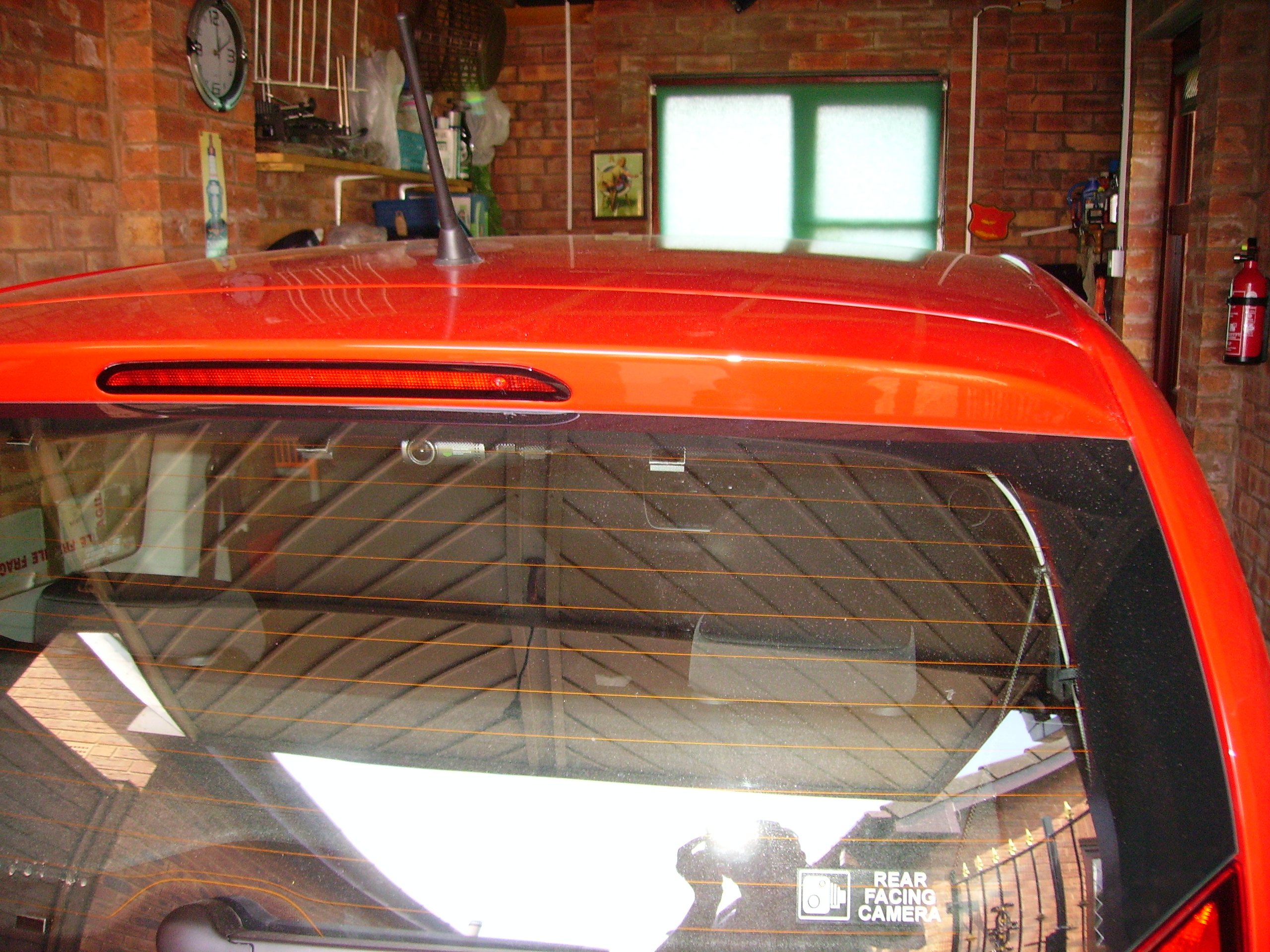

Being a cheap skate,I purchased a cheap camera from auction site £12.Camera is abour 3.5"long.Just clears my window sunshade when in place.

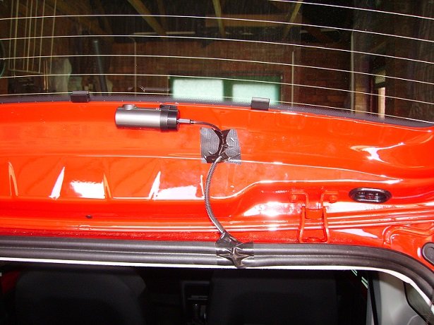

Not sure how long it will last,but fixed in,adhesive plate attached to tailgate frame,managed to armour the cable to allow for bending cable when opening tailgate.
I am not one to pull off trim,so cable was guided under the weatherstrip out of sight.Then routed along parcel shelf carrier  and down side of seat pad -clear of hinge(!)
Finally run cable behind seat belt,under sill weatherstrip and under driving seat to connect to fag lighter.....no cable showing when boot closed,and driving door shut.
All secured with black gaffer tape where need..not the neatest but simples....
