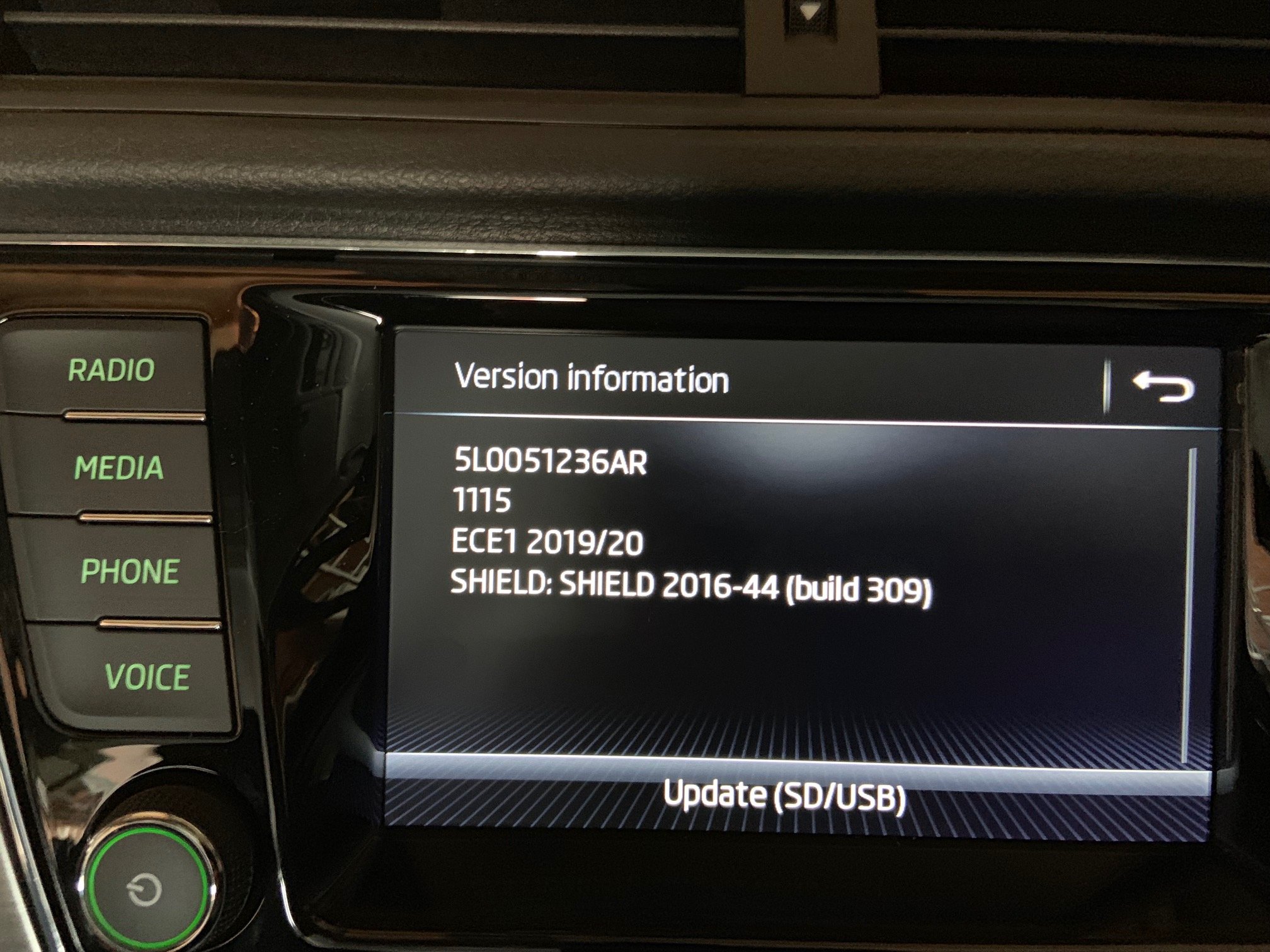

I have done a screen shot of the Version Screen on the unitIMG_3690.thumb.jpg.62520798f8a0f683381badfb6fbb1b7b.jpg
I did the long run over the week end and did find that both speed limits were showing.
I do still have the old original card and if I get the opportunity I will put that in again and se what happens.
