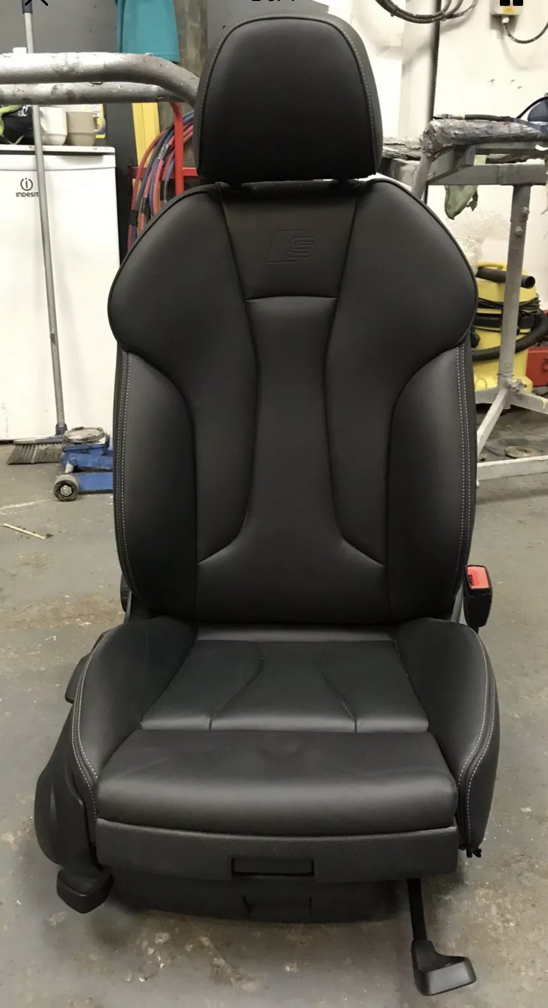

Gents, I’ve found this seat and I’m keen to purchase it, it’s apparently from a 2017 Audi S3, I’ve seen Audi S3 seats in caddy’s, Octavia’s before but unsure if the 2017 will fit my 12 plate Octavia, I understand the airbag wire will
need to be modified but that isn’t an issue

I don't see why not as I've seen members use octavia Mk3 seats in a octavia mk2  (both Octavia Mk3 and 2017 Audi S3  - share the same MBQ platform so don't see why not)
You may need to swap the airbag connector over by doing a bit of soldiering but the only thing to watch out is any electrical adjustment on S3 seat as this will add to complications of connecting up the electrics which is never straight forward on canbus wiring system.
