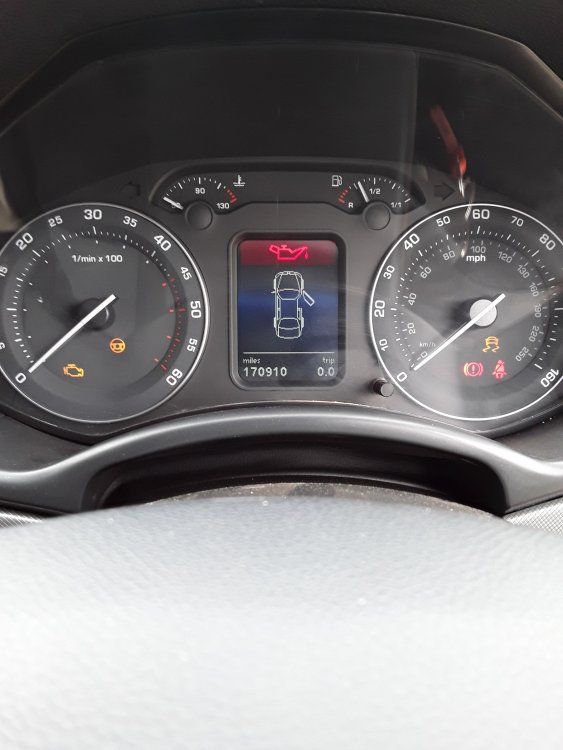

Having problems with mk2 1.9 TDI
Lots of lights on, in limp mode
Oil pressure light on
Also Emissions workshop ?
         Engine fault workshop ?
         Rev counter not working ?
         Glow plug warning light flashing ?
& takes ages to fire ?
Really need help 😭
How old is the battery? The lights you have on the display are typical of low voltage caused by a failing battery. The octy 2 is very sensitive to reduced battery voltage. Also check the battery connections for corrosion and tightness.
