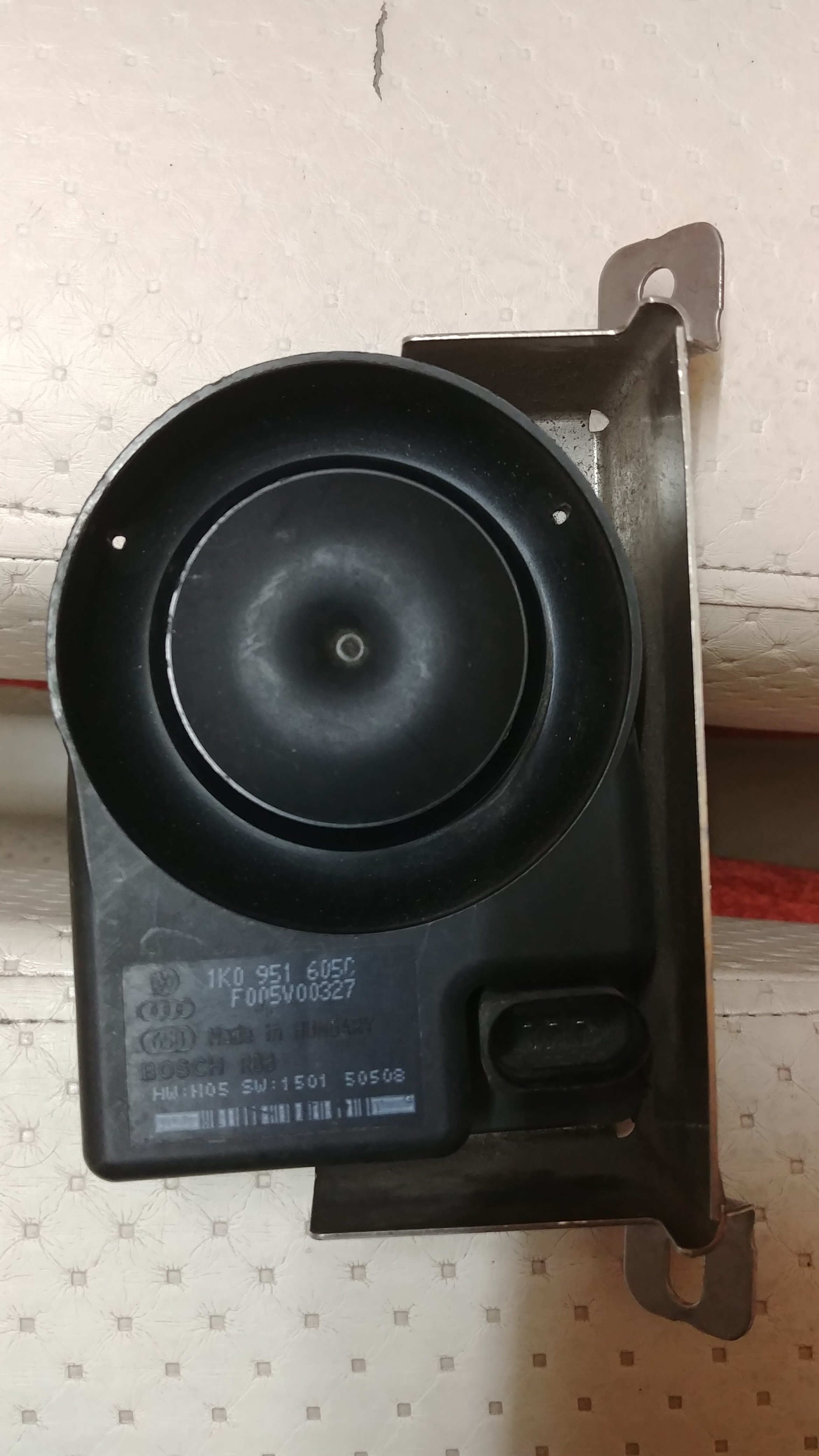

Recently I noticed that my security alarm siren had reached its end of life, the battery was dead and PCB was not in a good condition as well. So, I purchased a used one which has a serial number 1K0 951 605C where as my existing siren serial number ends with 605D.
I attached the new siren to find out it's not working. I tested it via a multimeter by connecting to the 2 left pins and I am getting 6 volts reading on the siren after removing it, I am thinking the battery is ok.
Is it that this different model is incompatible with my car or I need any vcds settings to be modified.

You now have two faulty alarm horns
they are plug and play
Only other issue could be a fault in the wiring
wiring info
12v
Ground
LIN Connection to your BCM
Hey Eddie,
Thanks for your reply. If I am getting 6volts on the alarm can it be faulty just out of curiosity? Is there any other way I can find if the horn is faulty? Can I test the wiring socket terminal for any voltage to check if I get the charging volts there?
