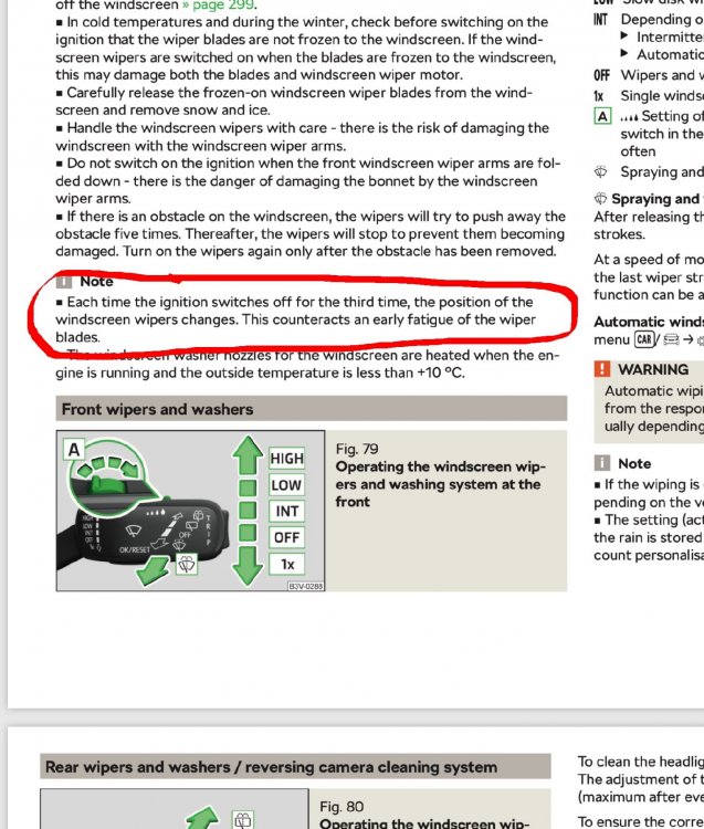

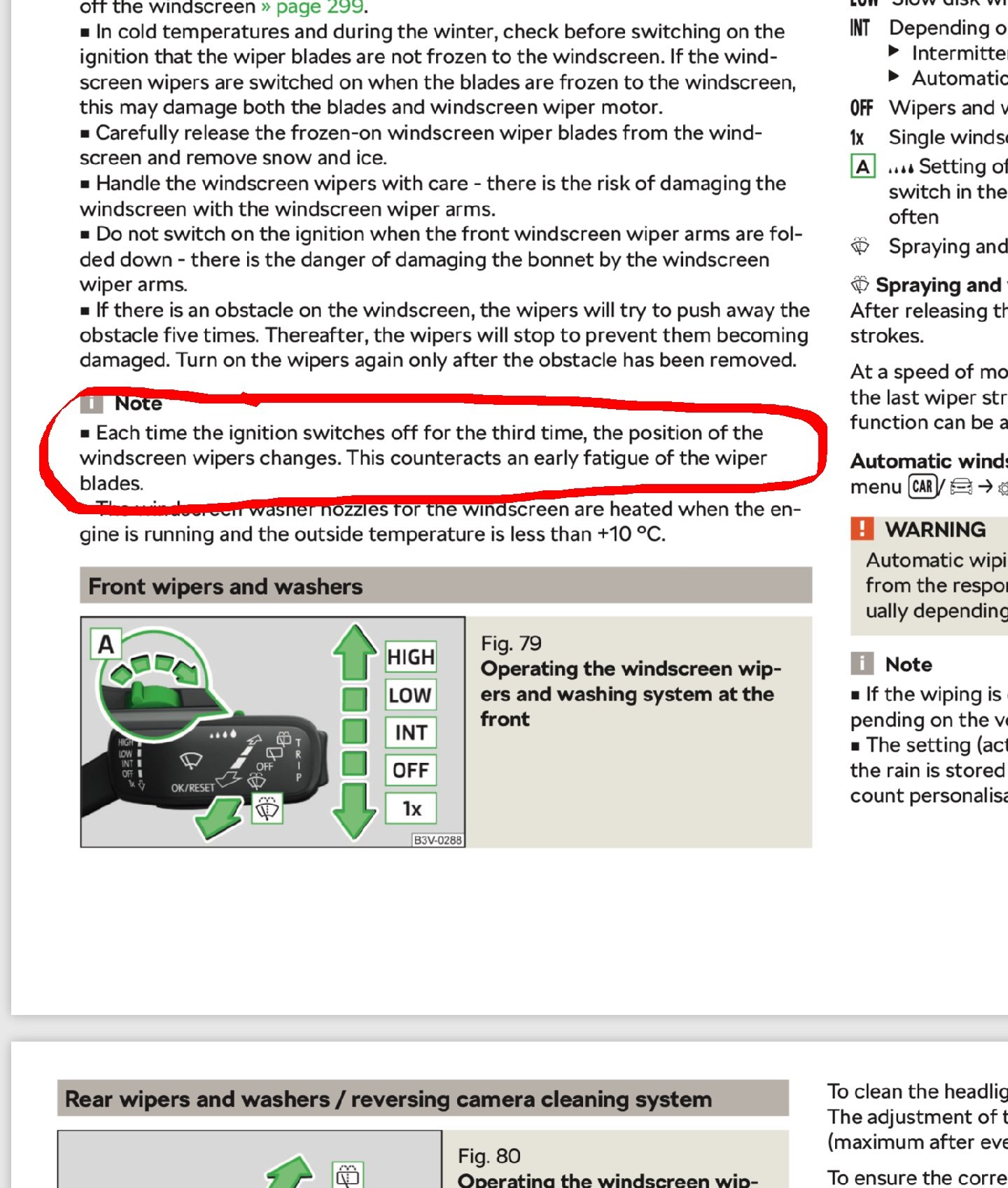

It’s the same as my previous Yeti, the wiper blades move slightly so they’re not in the same set position on the screen.

The only clunk though will be the wipers jumping a few centimeters with each cycle of the ignition.
Mines definitely the wipers and obviously in the heat with dry screen it’s even noisier
