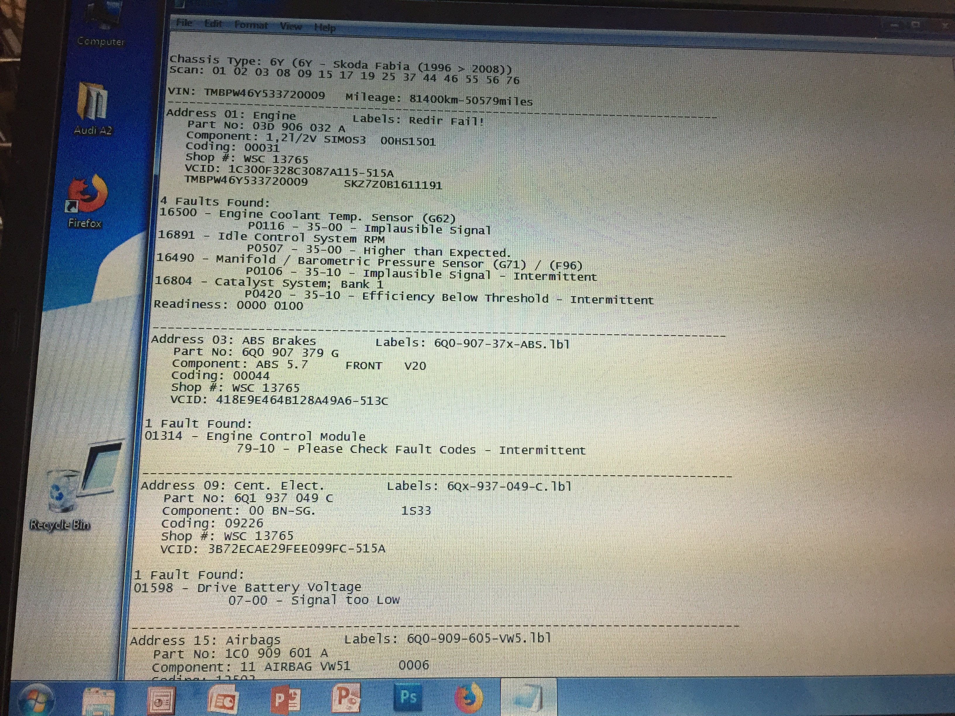

Bother in law has a Skoda Fabia 2006 1.2 Petrol, ran VCDS came up with intermittent camshaft sensor fault, replaced and cleared the faults, still getting the engine light coming on, scanned today and have the following faults ( see image attached )
Any help would be greatly appreciated.

I would fit a new CTS (common fault and you have the DTC for it) and get the battery checked out, then scan again as the faulty CTS could be giving issues for the other faults.

i have replaced the cts and cleared all faults, engine light came back on after 11 miles, will get the battery checked this week.

Check the brake servo pipework for cracks in the hard plastic sections where they go over hose barbs.
Either side of the non-return valve on the underside seem to be common spots for cracking.
