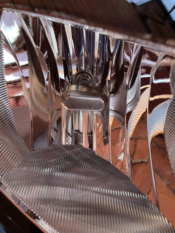

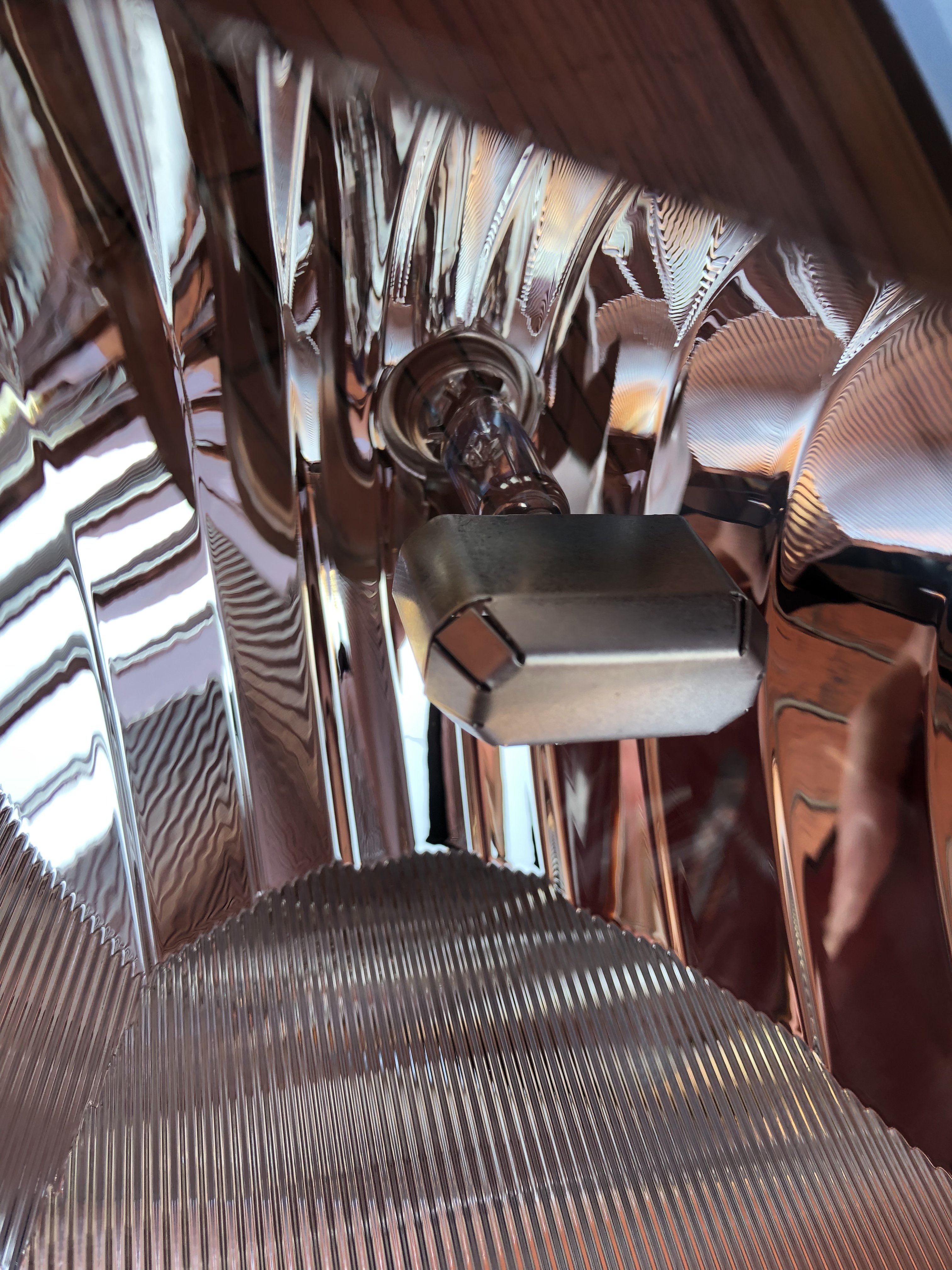

Hi I have just changed my bulb on my 2019 Skoda Citigo only thing to ask is I noticed when I put them back in the bulb is not straight when it is fixed back in to the lamp it is turned and locked in to place as it will go could someone check their and see if it is the same please
Like this or is it normal
Better picture

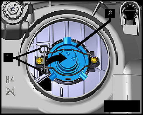

It looks ok from the photo. Have you compared with your other headlight? Failing that, re-fit the bulb, if it sits correct, then it's in the correct place.  The picture below shows how the buld fits into the headlight.

Mine is the one with single bikes for headlight and high beam yeah both headlights are the same and when I looked they are tabs on cups that lock it in to place and it will only go one way I have since sent pictures to dealer who have confirmed it is normal and I have looked a another Citigo same year and that was same as well so it is normal

Yes the beam patten is fine
the dealers have confirmed it is ok I also had a luck at another facelift 67 plate citigo and the headlight bulbs where the same.
