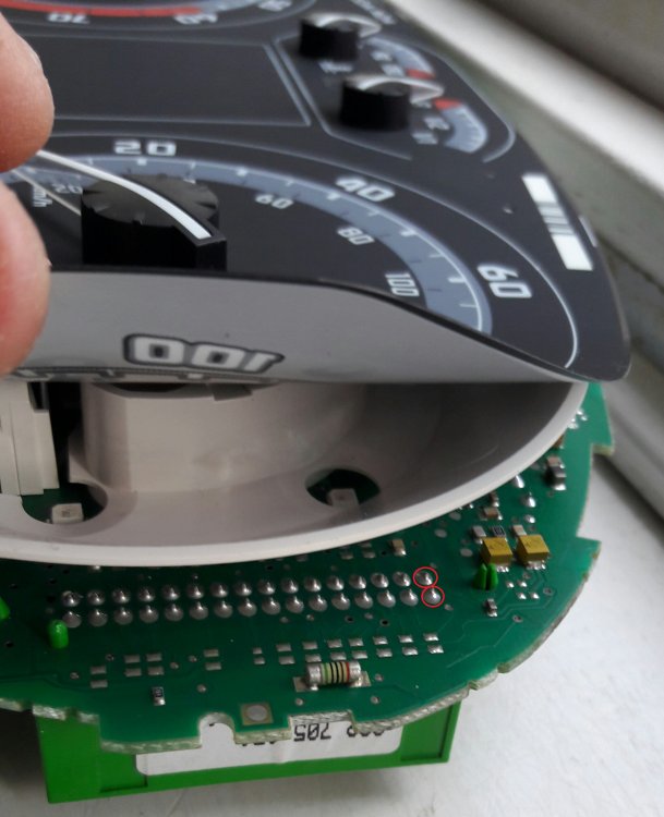

If what I suggested doesn't work, it's possible that you have disturbed a weak solder joint as they are known for this problem.
This pic shows the two immobiliser solder joints which can sometimes need reflowing with a soldering iron...
20160711-192150-1-thumb-jpg-72e6fc4911cd
I've seen this on YouTube. And I don't think that this is the problem. This seems to be a problem that appears overtime. I just removed the cluster, replace it for 2 minutes with another one and put the old one back.
It's just something to check if it still doesn't work after you've done the other stuff. The solder joint/s could have already been weak and may have been disturbed by removing the connector. It's probably not that but worth bearing in mind. Let us know how you get on.
