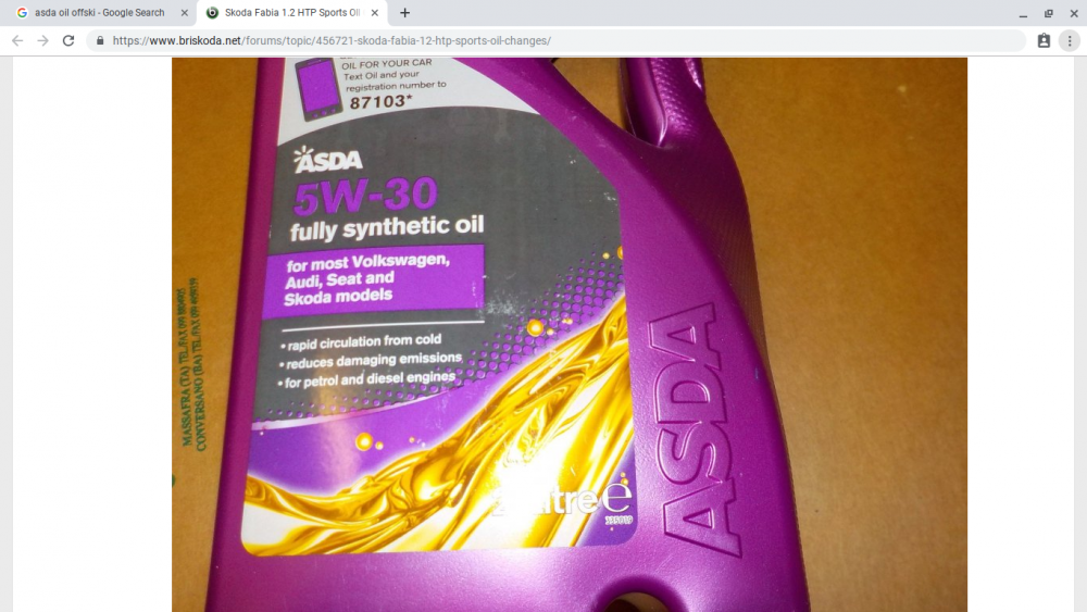

I recommend, ASDA Branded. 'Much Cheapness' and produced by an Oil Manufacturer not a Baked Been producer.
So any VW 504 / 507 so 5w 30 FS LL oil,
or VW 504/507 spec from any source of trusted retailer.
A forum sponsor does oil.
http://opieoils.co.uk
Makes no difference, it is a 2.0 TDI.  Just needs 5w 30 FS LL to VW504 / 507 spec,
ASDA TESCO, Motor Factors, anyplace sells it.

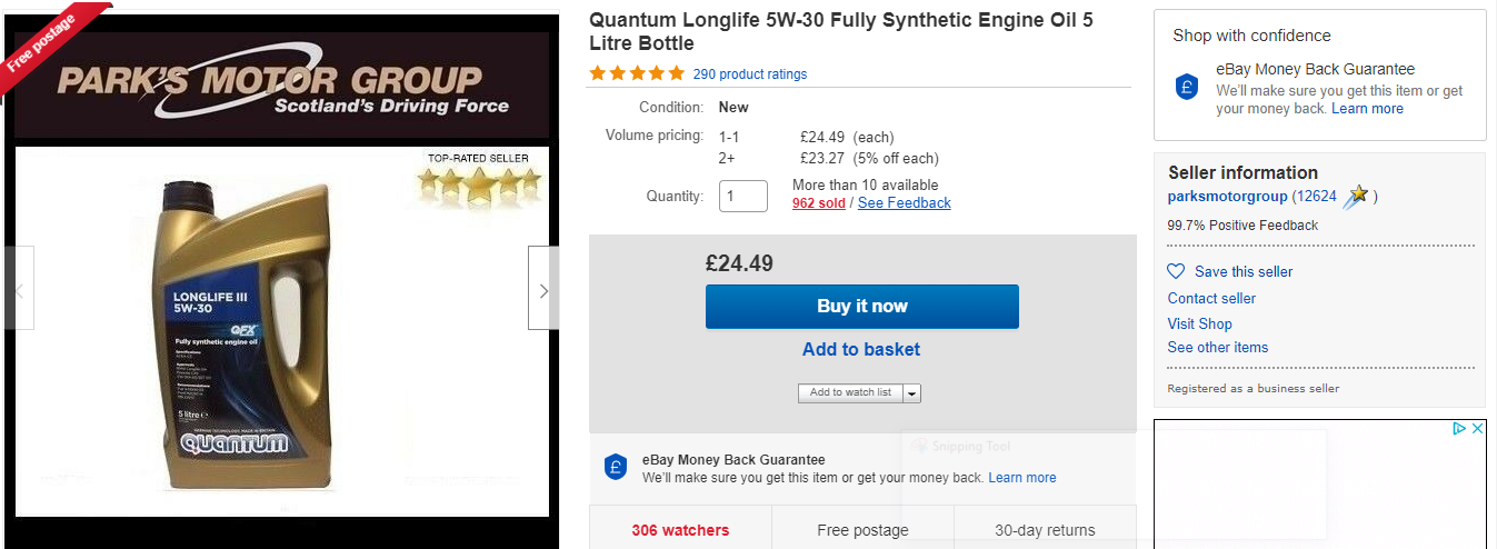

What many or most of the Main Dealers use.
What you might expect Parks of Hamilton (Parks Motor Group) to use when they are servicing special offer or not, but then you can not trust them as far as you could throw them.
52 minutes ago, neonplanet40 said:
So this should work with no issue with my diesel?
Thanks for your help guys
Yes, this oil is suitable for all Skoda diesel engines, including those with DPF (Diesel Particulate Filters). This is the oil your local Skoda franchised main dealer uses.
