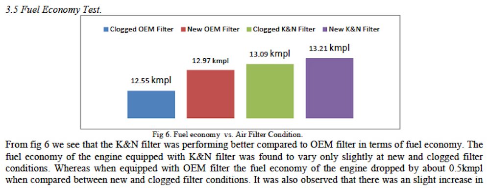

No performance improvement if the filter is just making the car use more fuel without the car breathing better....
... but interestingly clogged K&N is still better than new OEM (according to this study)

Forget studies, try a car for yourself with a clogged air filter.
Not rocket science really.
I have used K&N Filters for decades for the right application.
You know they are dirty when the fuel consumption increases.
Performance in a short term test is all well and good. However what about actual filtration of fine dust.
A poor filter will allow things through, so will  flow better, but filter less well.
looks great in the quick test. The dust however blasts the turbo and engine, damaging them, reducing power due to wear and eventually an expensive failure.
so sure look at flow, but make sure you look at actual filtration too
