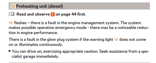

I'd certainly have it looked at. This is what the manual (confusing as usual) says.
I think it means there is a problem with the glow plug system if the light doesn't come on before start or stays on continuously when driving. Just my guess though.
The "page 44" reference is just to their usual don't drive if the warning tells you not to, pull over safely etc.

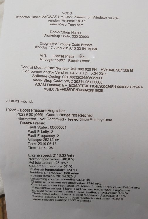

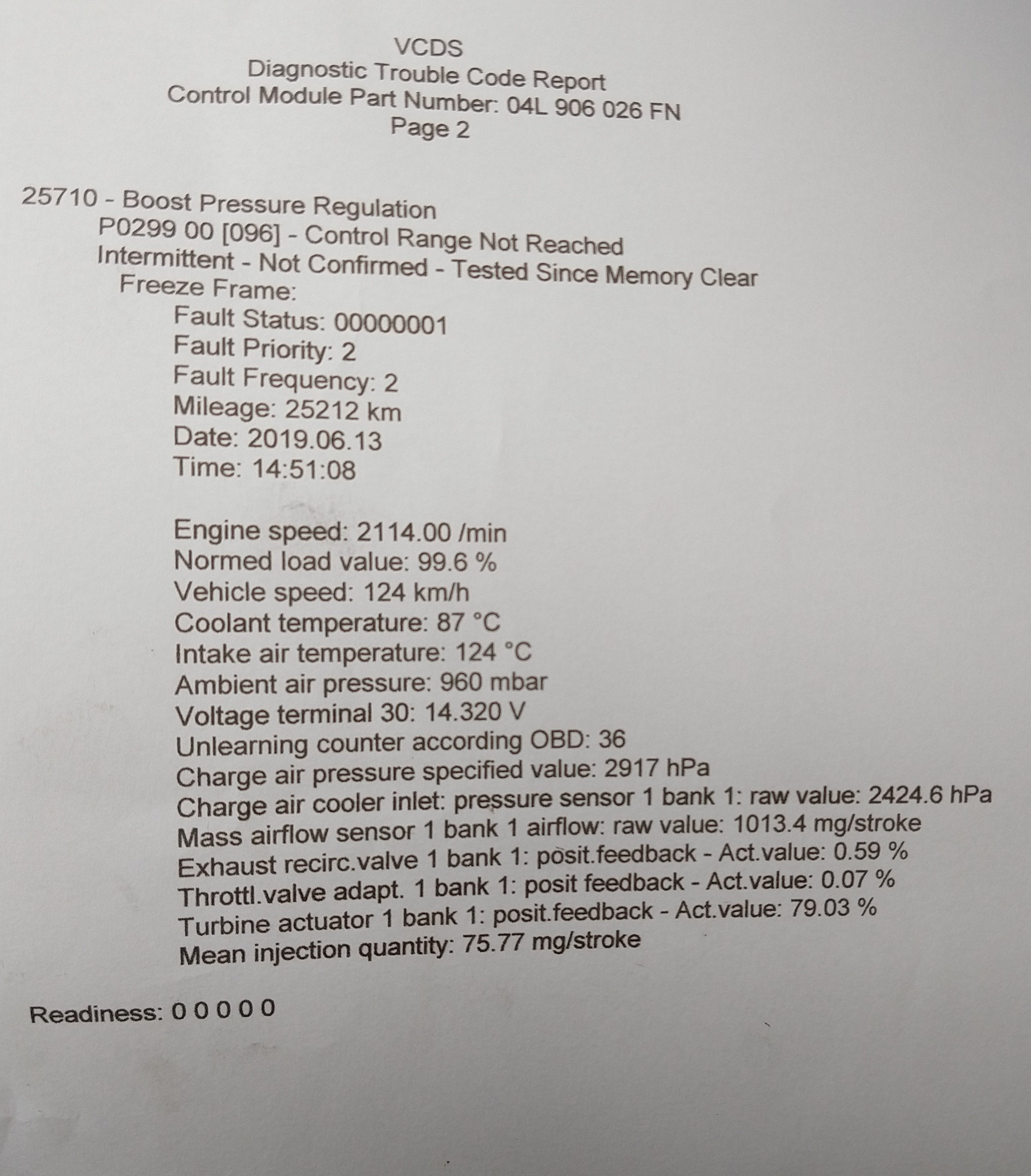

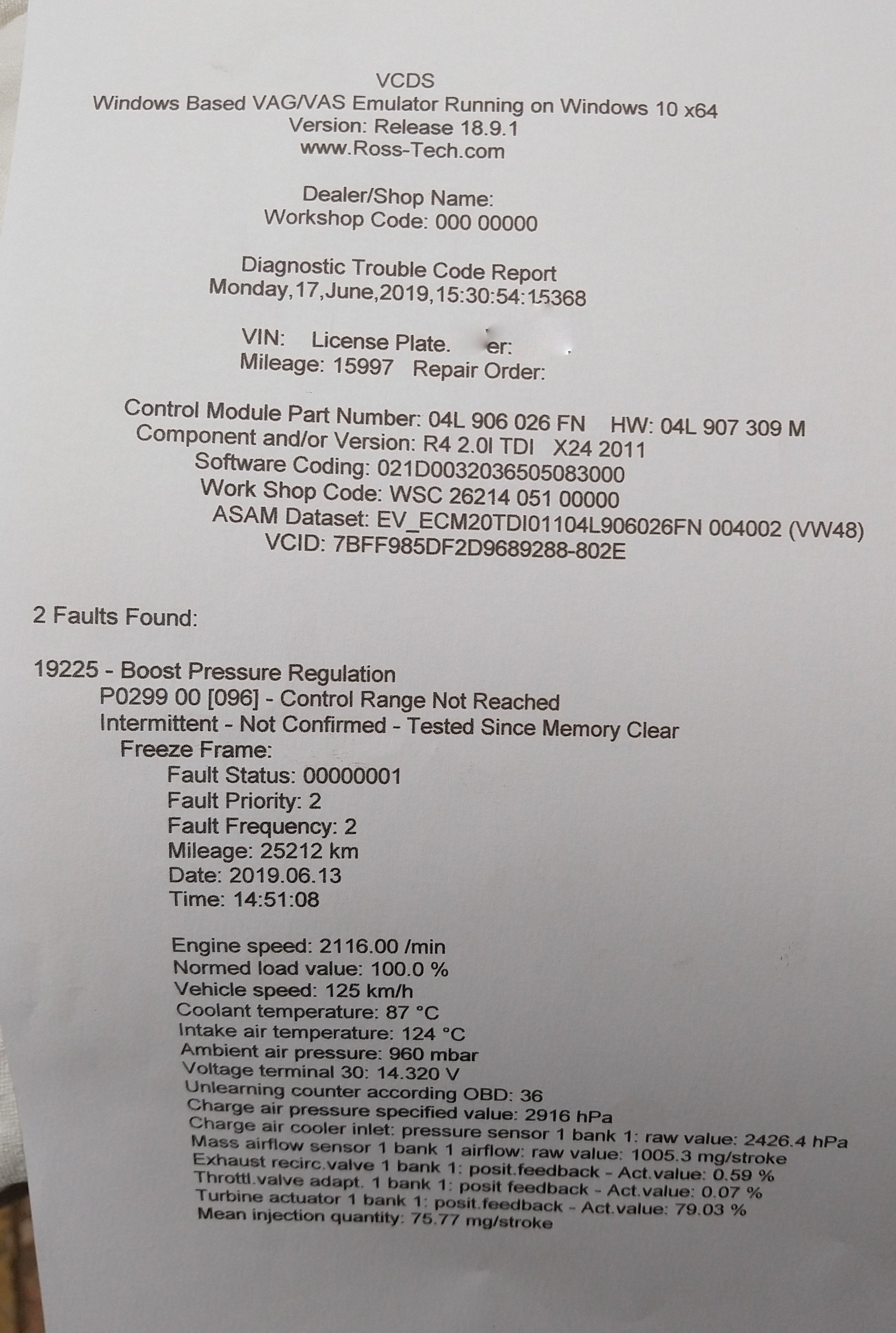

I went to an independent for advice, printouts attached. Gobbledygook to me but he said to show it to the garage I bought it (Arnold Clark) and if no joy a Skoda dealership. He said it should be under warranty "but you know what they're like"

Well DM Keith have had it today, and are keeping it until Monday.
They read it and did some diagnostic tests and some anomalies were found however no real fault as such. It was taken out to try and replicate the scenario but was ok.
Tech guy thinks it might be an intermittent fault with a boost sensor but is checking with technical later.

@muddyboots similar to yours in that no real provable fault was found, however a boost sensor was suspected so after advice from technical they said they changed it, taken for trial runs and no faults found.
