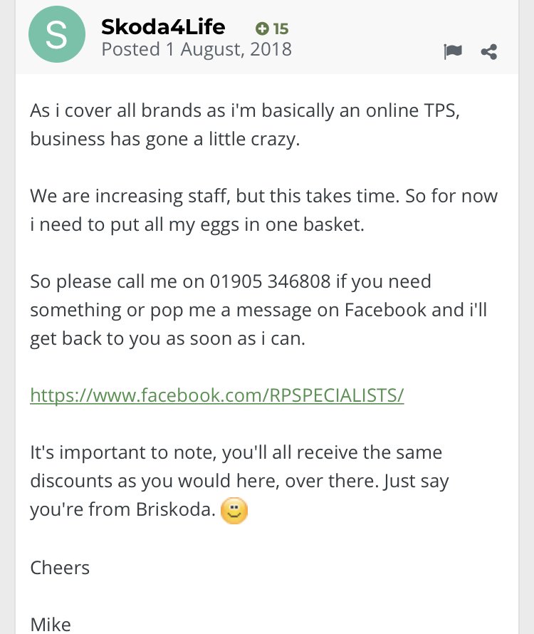

Mike had moved over to the Coventry branch of Listers now so it will probably be Andrew or Ross that pick up any requests. Mike is still involved though.

Thanks Techie, I was just reading through thread and came across it, so will give him a call/ message and take it from there. Many thanks again.
