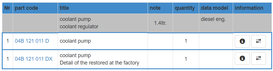

Hi Techie, many thanks for your help. Our local mechanic is going to fit the part but I was maybe going to order it in, Trouble is I don't know for sure which one is the correct one, can you help?
Which if any of these would be correct for job? I'm wondering if more expensive one is more of an upgrade to same part rather than direct replacement like for like?

There is clearly a big difference in prices, autodoc are selling the water pump and timing belt replacement kit for around £250 while Skoda dealer is quoting £450 for the water pump part alone, plus fitting and vat. Plus cost of timing belt and accessories.
Any help is very much appreciated.

First one is brand new, second is an remanufactured exchange unit (as per description).

3 minutes ago, Wino said:
Strange, when I look up the part numbers in Tech1e's screenshot on allcarpartsfast, genuine parts are considerably cheaper than that:
(1st two results here) https://www.allcarpartsfast.co.uk/search.php?search_query=04b121011d&section=product
Buying genuine seems the way to go.
Thanks, my trouble is working out which of the two is correct, the one ending in D or the one ending in DX. I'm currently conversing online with autodoc and they are recommending 2 HEPU water pumps, one at £38 and the other at £186. The 186 one comes with integrated disabling contact and integrated distributor and seal, the other doesnt.
If I knew for sure which of the two you have linked was the correct one I would order it and be done.
Thanks for your help, greatly appreciated.

They are exactly the same thing, just that the DX one requires you to supply the old one back to the dealer for a rebate.

Just did. Exchange part no longer available, £88.49 inc VAT for a brand new genuine pump
