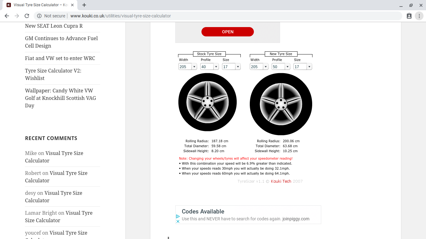

http://kouki.co.uk/utilities/visual-tyre-size-calculator

I'd like to keep the 17 inch wheels really as they're part of the Monte Carlo spec, I checked your suggested size of 215/40 R 17 on the online sidewall calculator and it tells me that the sidewall is only 0.16 inches bigger so I don't think that'll make a noticable difference, the difference between 205/50 and 205/40 is about 0.8 inches so I'm hoping that should be enough to soften the blow of a bad pothole. I've spoken to the insurers and they are happy for me to change sizes, also the speedo reading should still be about 96% of the original reading with the smaller tyres fitted, so a previously indicated 30 mph will now be showing 28 mph, This sin't too bad because I've noticed that when I pass roadside speed indicators at 30 they usually say I'm doing 27 or 28 anyway so that's a bonus because it'll be more accurate, I'll just have to remeber to be more carefull and not assume that I have a margin for error, or I suppose I could get it recalibrated but I'll see what the car is like on the tyres first before I change anything else. Thanks for all your advice.

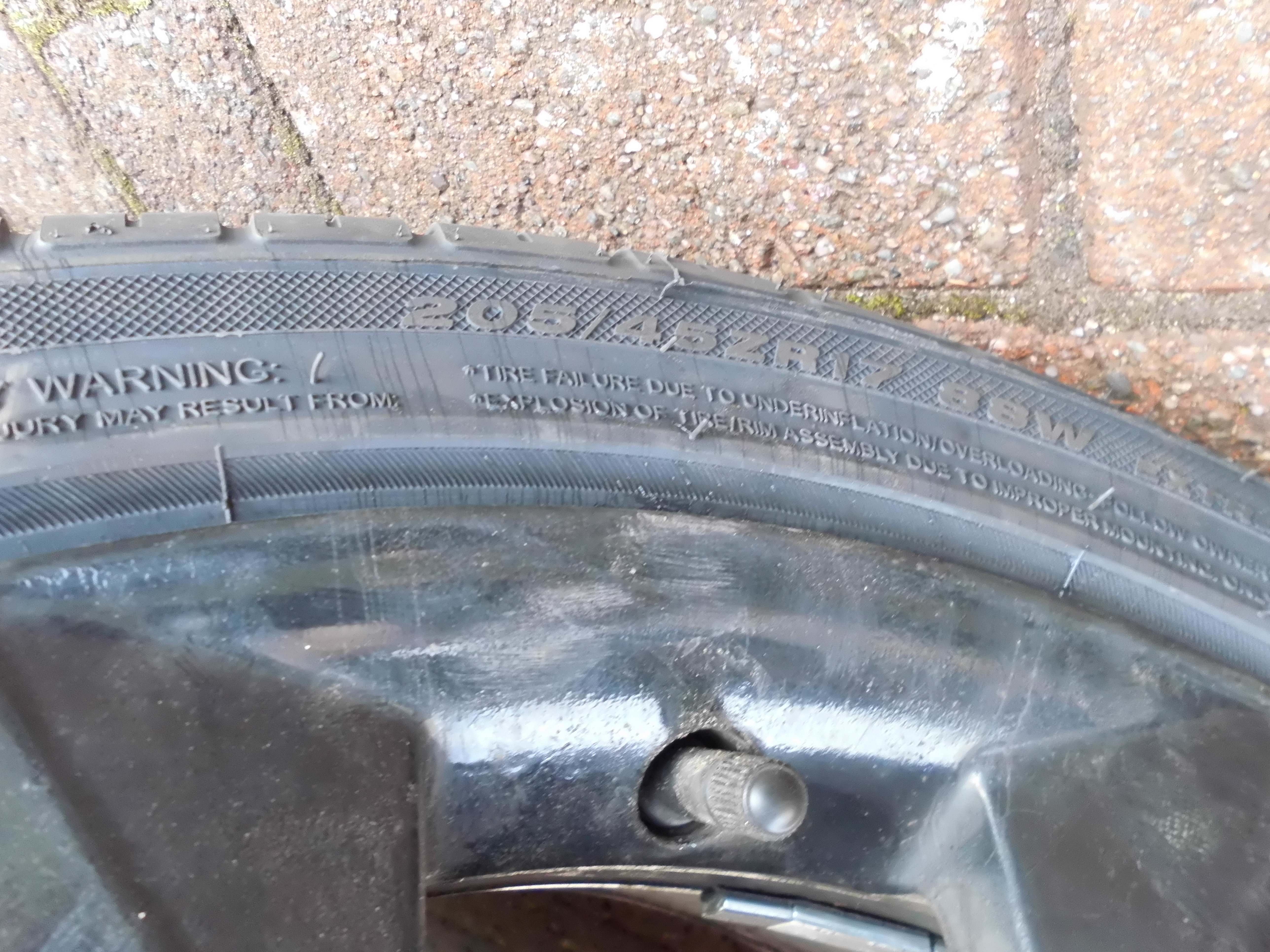

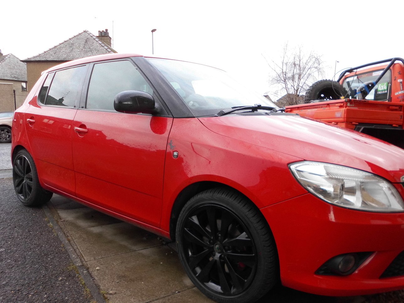

I have run various size 17's and 16's on a Fabia vRS.
205/50 R 17 is simply too big and you will hate them, but on you go and try and find out for yourself.
I have pics of 205/45 R 17's which i run in Winter.
They are not going to stand up to potholes if you hit them hard enough, but there are some pretty good XL's out there that do pretty well.

Just had alook at your pictures thanks, the tyres in the boot and the one fitted to the car in the second photo look like the winter tyres, so are they the 205/45's? what sizes are the others?
