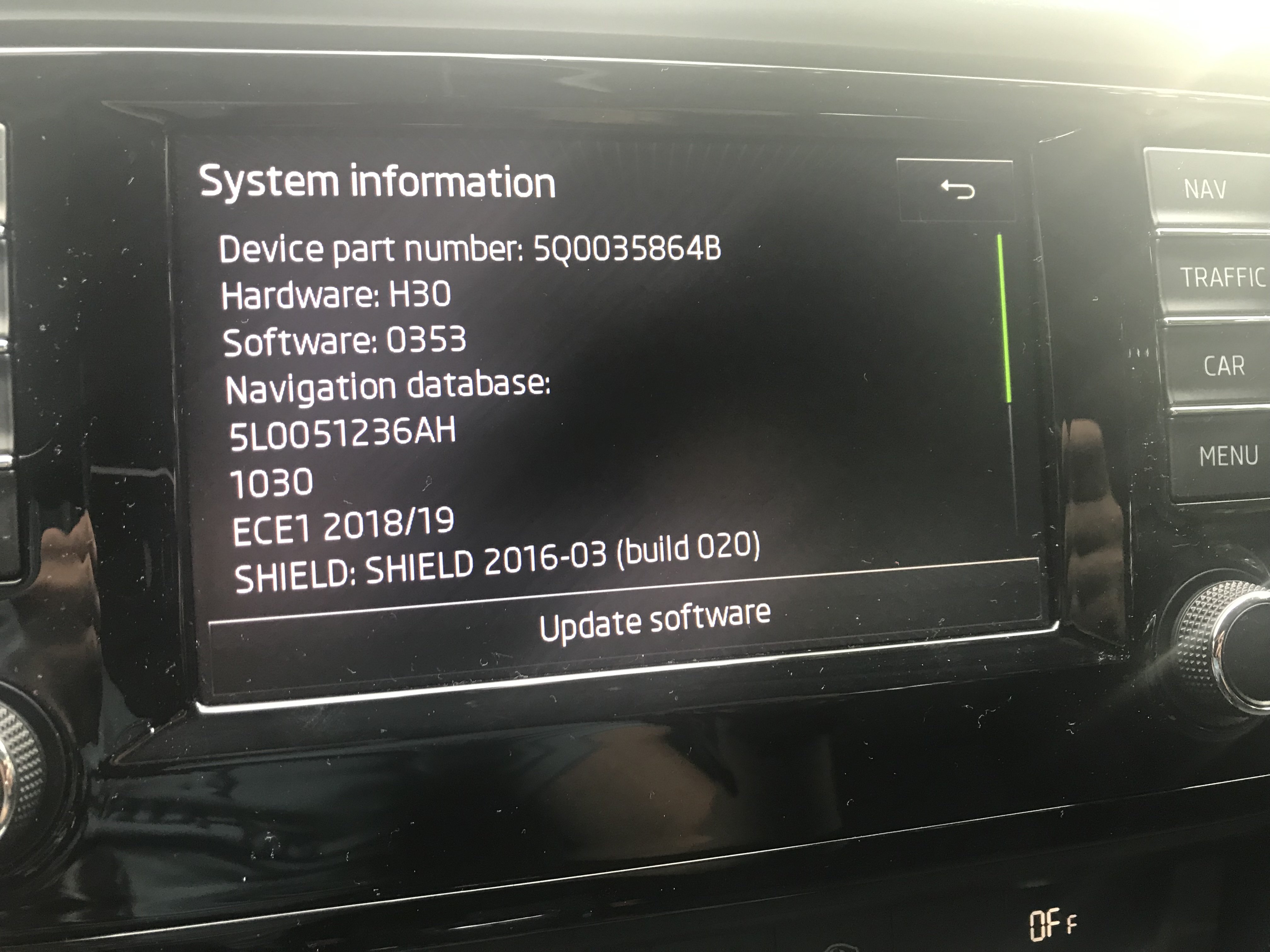

My car is November 2017, ordered in July 2017, and has a Columbus with 2 SD card slots and a CD player in the glove box.
That’s it the system information about my system.
Edited by Skodafabian
CD player in the glovebox is the main unit.  The screen is just that... a screen.
5q0035864b (and a 2017 car) means it is definitely a MIB 2 system.
The Amundsen units of this age certainly had deleted the CD player.  I'd forgotten that the (rarer) Columbus units had retained it.  Sorry if that caused any confusion!

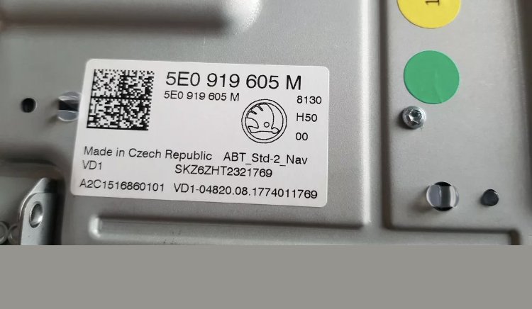

You can indeed retrofit the glass 8 inch screen on this radio with no coding changes. Part number you need is 5E0919605M.
Thanks for the info. I will need only display, right ?
Do you have an idea where I could find the “ glass “ with this part number ?
I found some variants in EBay. Is it only “ plug and play “ or I will have to make some modifications or settings?
Thanks in advance!
It’s fully plug and play, you might need to shave down a plastic connection but that’s all. I use eBay for bits like that. Make sure you get one with the bottom trim. That’s not a separate part you can buy.

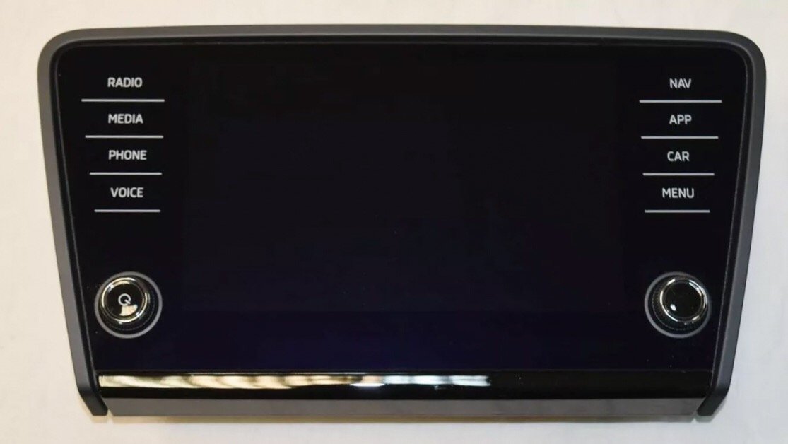

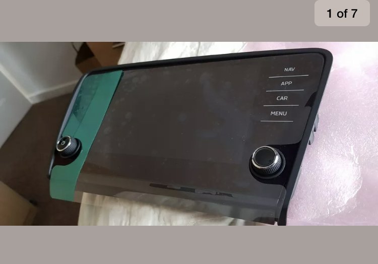

See below, the trim is missing on this one
this is how it should be

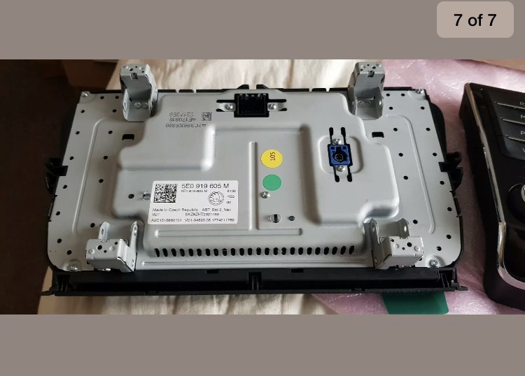

There are 2 connections on the back, one connection on the car may need a locator tab shaving off with a craft knife to fit properly, very easy to do and will be obvious when the screen arrives.

When you have free time could you spend 2 minutes to see this COLUMBUS and tell me is it compatible with my system. Thanks in advance!
Best wishes!
It is compatible, it’s an FL Amundsen display, it’s not a Columbus one. Plug and play with just one plug locator to shave down.
